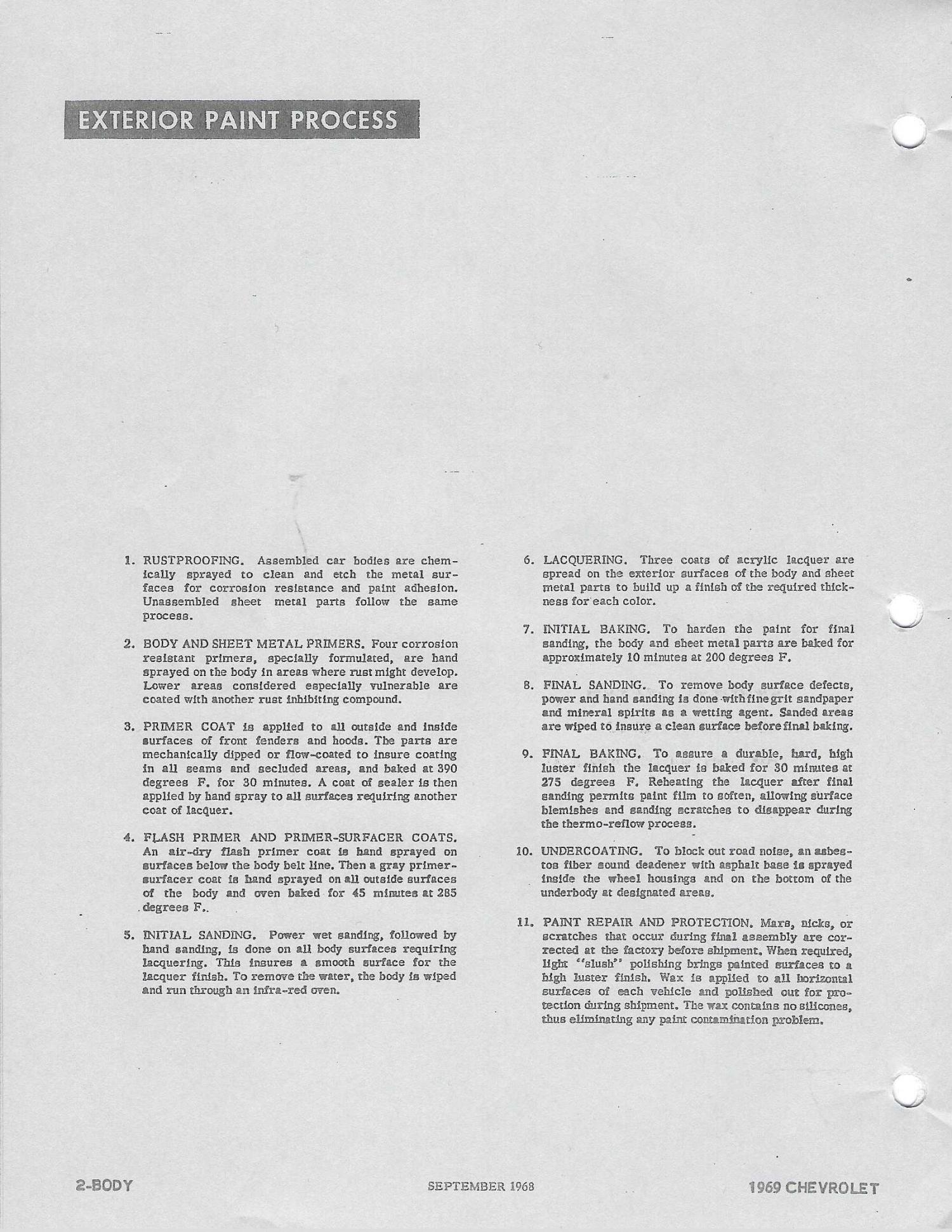

A lot of great information has been shared. There were standards (method sheets, process controls) in each gear plant. It appears as though there were variation in how paint was applied on Chevrolet, Buick, Olds, Pontiac axle assemblies....
I thought you might find this interesting. Here is a book/document from Chevrolet Engineering Center. It provides overview of the Exterior Paint Process.
www.vintagecertification.com

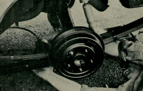

As I noted in the other thread, the wheel studs had some sort of sleeve (I assume cardboard or tubing) slid over them before the paint was applied, so the threads did not get painted. On low mile survivor 65-67 Chevelles you can see a donut of bare metal on the drum face around each stud, that shows where the outer diameter of the sleeve was. You can also see paint on the very end of the studs, so the sleeve was open on the outer end.
The studs were plated with a black finish to begin with, explaining why the threads also appears black in that pic.
Also note that hex shaped bare spot around one of the studs in that pic. Suggests that at that time frame (is that a 68 in the pic?) one nut was run on one stud to hold the drum on during shipping and until final assembly of the car.

Yes. Later the one nut was changed to a push nut.
Photographic evidence indicates that the axles were usually all black for the 12 bolts and the early 10 bolts.
By 1973 the center section was typically shipped natural and the remainder of the axle was still painted black.
By 1975 GM discontinued painting axles all together. The shipping racks and the assembly process at Norwood left significant cosmetic damage to the underside of the axle tubes and quality scoring was tightening to create competition between plants. GM Assembly Division was pushing to get rid of the paint altogether in order to raise the quality score due to demerits that the assembly plant had to score against their own assembly process as the scratching was a normal and unavoidable outcome of how Norwood handled the axles for assembly. As a compromise GM engineering adopted the position that surface rust alone provided a sufficient corrosion barrier to meet the survivability standards required by the warranty commitments at the time of sale and since there was no paint to mar or scratch - the quality demerit issue was removed making Norwood slightly more competitive with the other assembly plants using more up to date conveyor material transport systems.

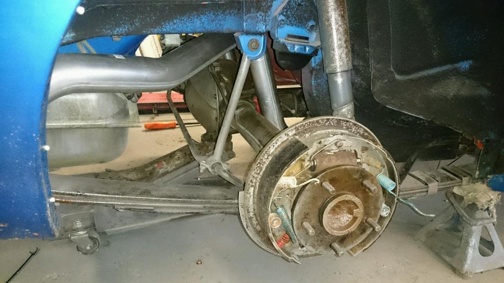

Just putting this here for the record. This is my low-mile 1970 Trans Am after evapo-rust bath. There was nary a hint of black paint on the axle anywhere. dark cast center section, bare tubes.

Great Pic Tracker1. This is pretty much what i have seen on my survivor 70 TA. Very Very Light surface (almost impossible to describe as) Rust. You ca brush it off. Easy to see it was Bare Metal as well.
Thanks for posting....Look at all that over spray.

yeah this one was crazy with overspray - the line painter must have been a new hire from a Mopar plant

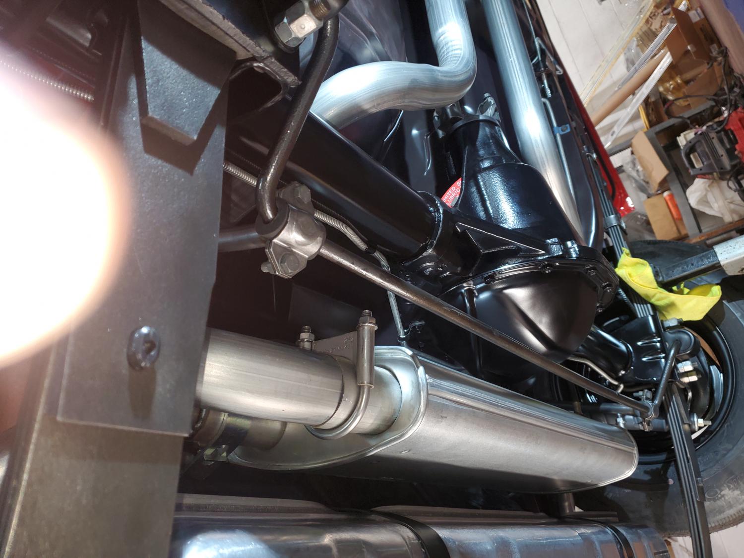

Hopefully this helps. This is how I restored my 70 L78 camaro rear 12 bolt. Pretty much painted everything with the drums on it semi gloss black. The paint used on the rear axles wasn't very good and didn't hold up well.

Don't want to get too off-topic here, but are the sway bar bracket caps silver or is it just the flash?
