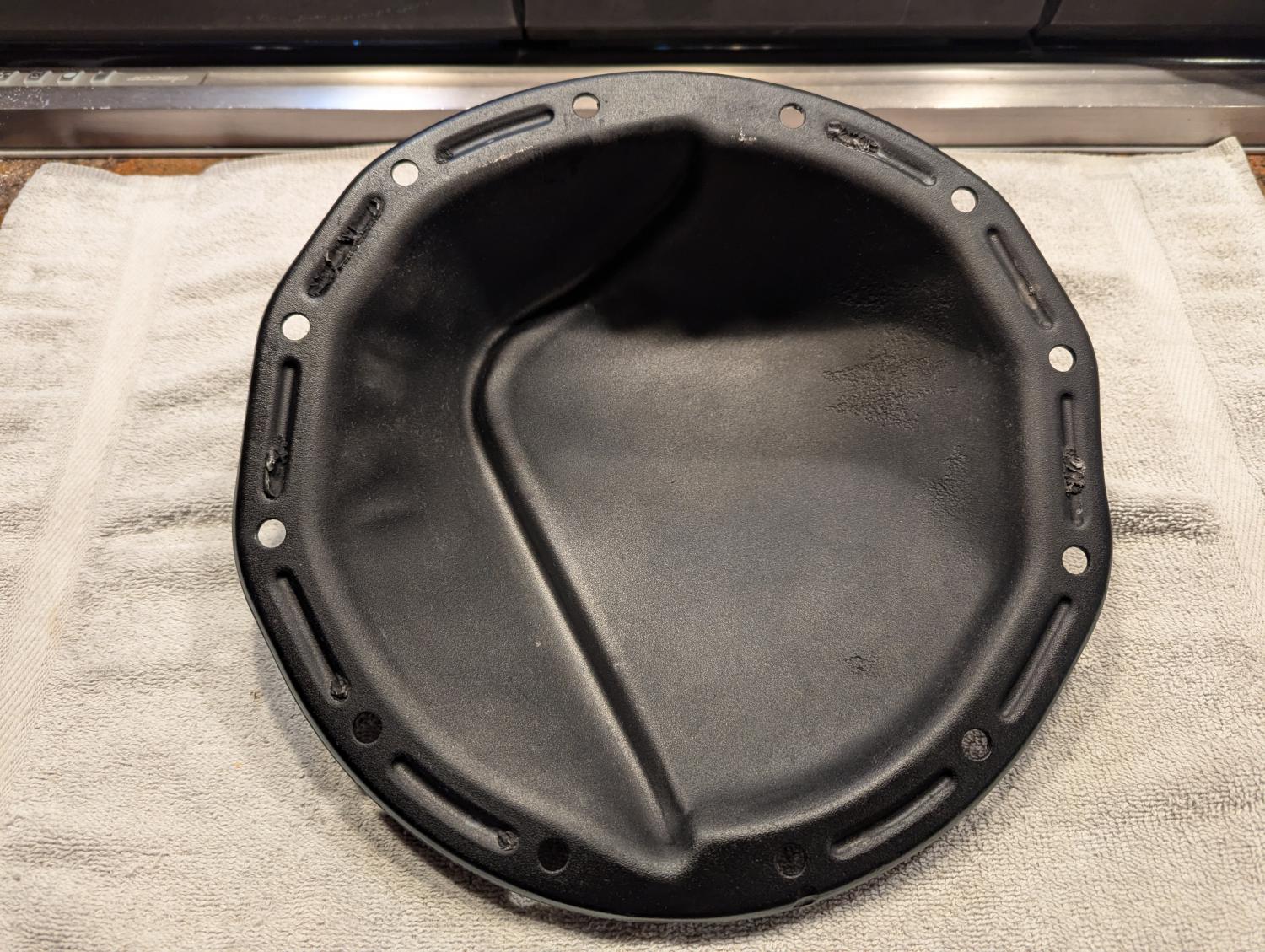

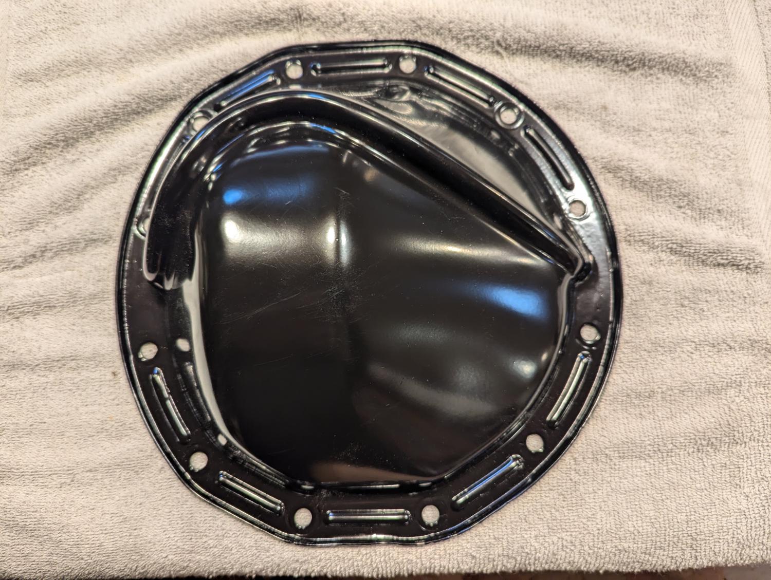

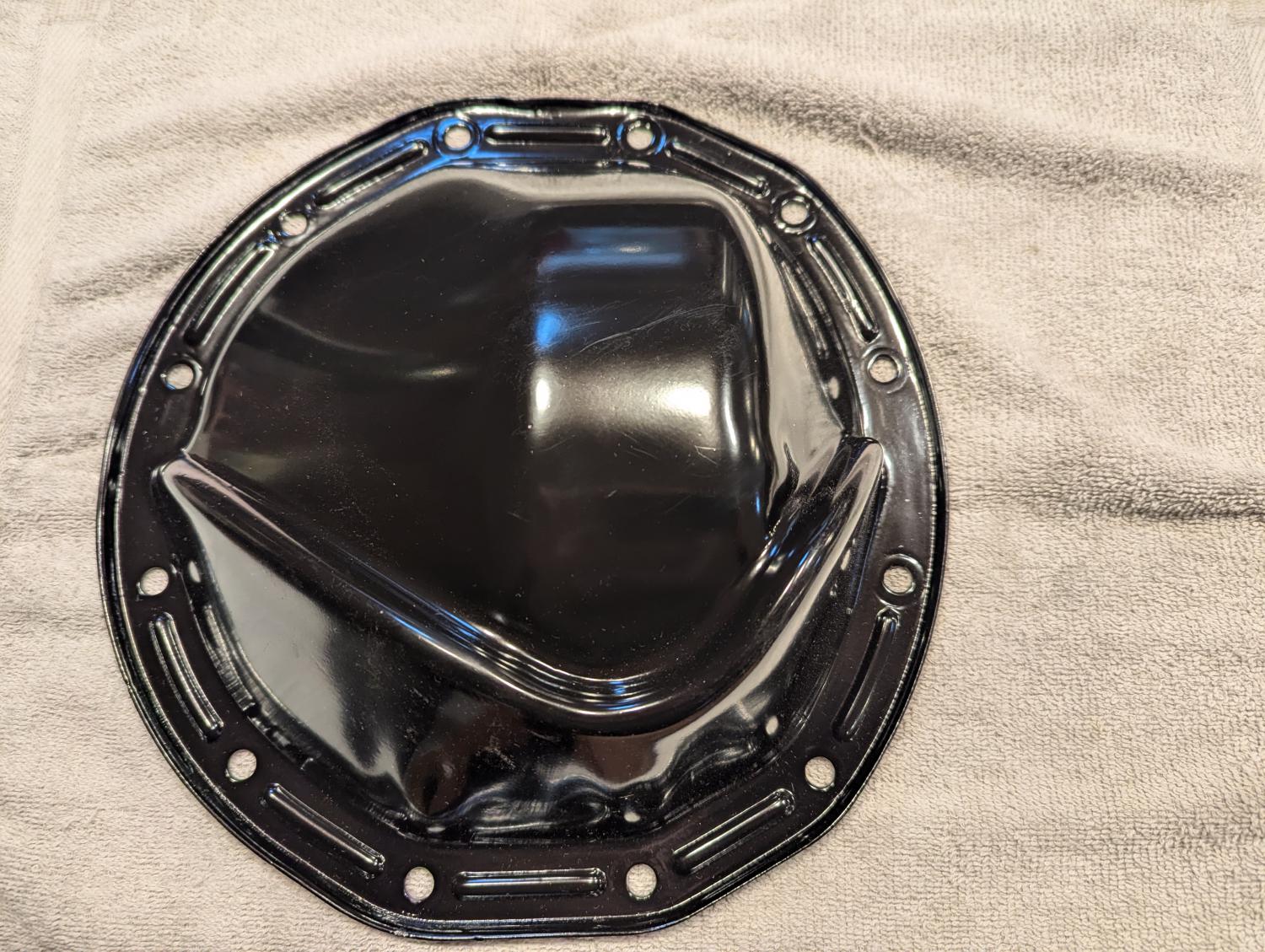

I have what I believe is a USED, GM/OEM No Notch 12 Bolt Cover.........
I cant see any stampings or ID markings
Someone suggested it was a truck cover.........
What do I have and what is it correct for ?????

That is not a truck cover. It's a Chevy car 12 bolt cover.

68- 69 Chevelle for starters.

No conclusions yet..............Is there a list somewhere that states all the different 12 bolt diffs that had a NO Notch Cover.......like my above pics ????

I think the 12 bolt covers with the notch are correct for 1970

Early assembled 1970 Chevelles received the no notch cover.Later + assemblies got the newly designed brake line clip "notch".
