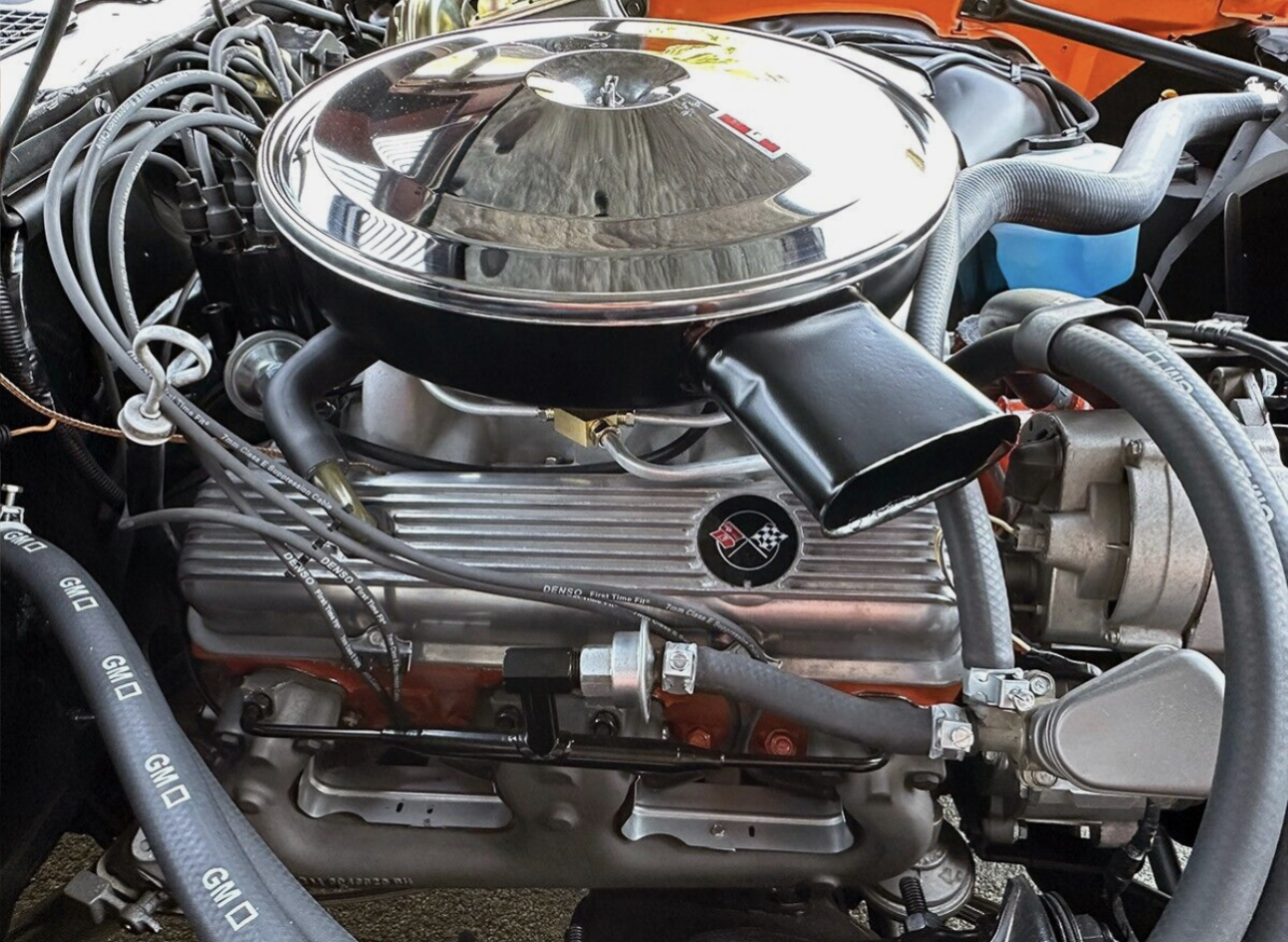

Besides non original RS and wrong stripes, and a few other small things,
what do you see wrong with this engine compartment ??
Can anyone explain? Hint.. M-21 car.

Trans dipstick.

Never seen a TV cable on a muncie.

Look who's selling it.....that speaks volumes.

----If he has the NCRS paperwork, why not show it? Very suspicious! A ten year old child could get the stripes better than that....Bill S

That dipstick would be handy for checking the gear oil level in the Muncie! What are these people thinking, that no one would notice....

Stripes totally ruin the car for me !
