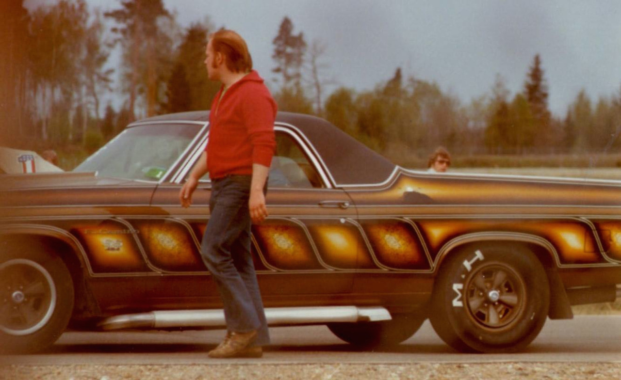

Would like to teach myself how to do some of the psychedelic paintwork seen on gassers and race cars of the late 60’s and 70’s for when I paint my gasser. Does anyone know of any books that explain in detail how to do paintwork such as fine line, lace, quilt, endless line, fantasy panels, swirls, and other fun stuff? Included is a couple of pictures of that style. I’ve done some body and paintwork before but will be in way over my head and need it clearly explained.

That El Camino is the bomb.

I’m partial to that Corvette. But the Elco is neat. SS454 to boot.

The paint on the Corvette has to have involved more than 1 artist and took MANY hours to complete. I won't live long enough to learn HALF what it would take to do that job...
I do like the Elco, but the shadowed, block job on the Dart is my favorite.
