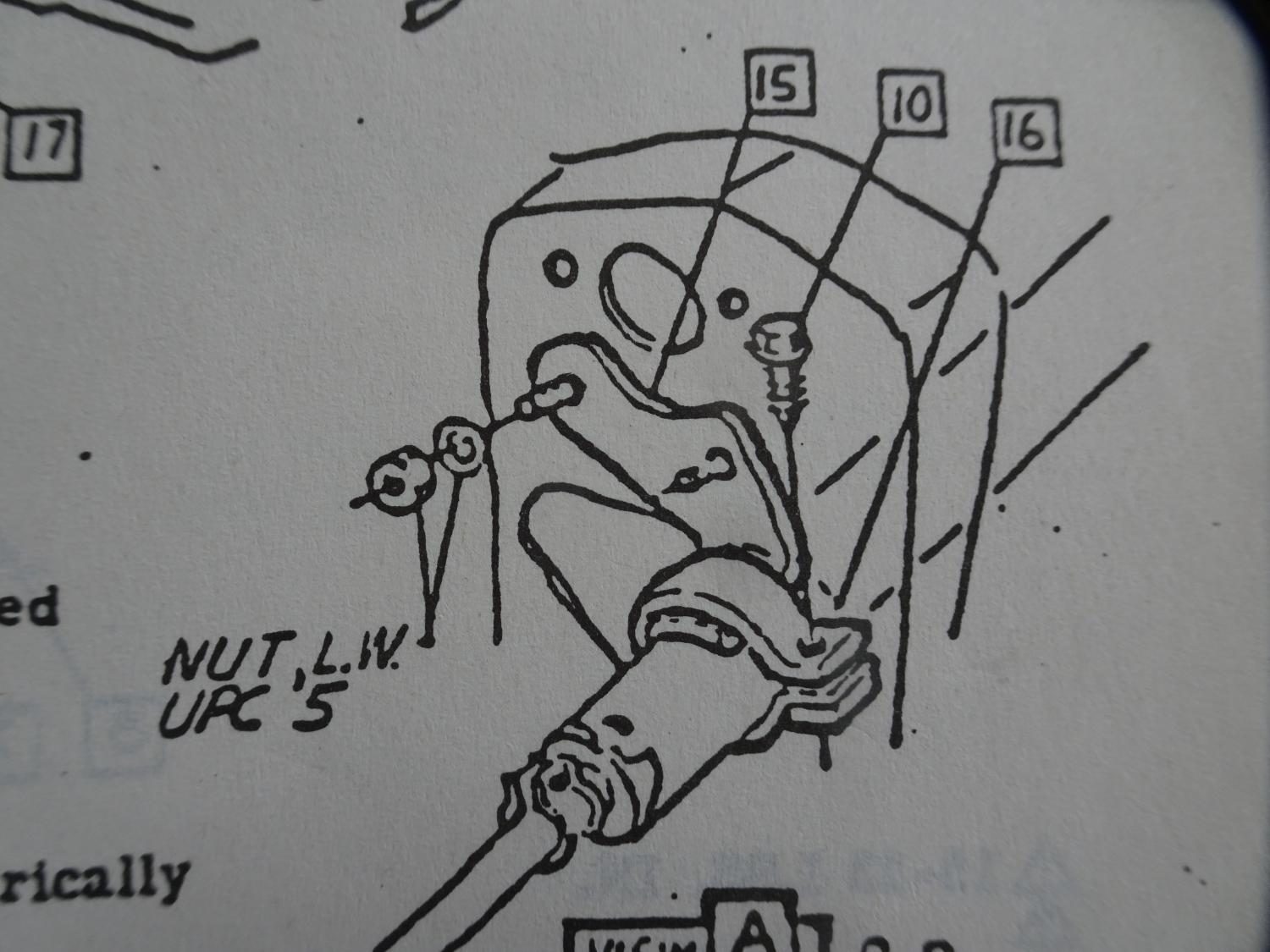

I have been working on getting the original column reassembled and back in the car, but am missing a few pieces that I don't have and don't recall removing during disassembly. I, also, can't find anything like it on the www to purchase. I have a similar part for the Camaro, but the shape at the bottom seems far different than what the Chevelle would be to sit flat.
First is a "grommet" that is basically a rubber cover at the bottom to hide the metal mounting plate. On page 384 of my AIM, it is item K in the pic and there are no part numbers associated with any of the parts on that page. I'm wondering if anyone has a part number to search for this part, or a grommet they would sell.
The second part is a bracket and clamp that mount under the master cylinder and hold the end of the mast jacket. This is on page 159 and there are part #'s for these pieces. I don't recall ever seeing anything like this on my car, or removing it.
Thanks for any help people can provide...
Mitch

Mitch, Jeff Helms can answer better than me but..
I recall him saying the rubber seal is just that, a piece of 1/8” or .080 flat rubber. The repop is a 1/8” piece of foam.
The mast jacket clamp/bracket, if it’s the same as 67, I have one and you can have it, with fasteners, if it’s correct for what you need, that I’m not sure on.

Bill, thanks for being willing to look at yours, I appreciate it.
Steve, thanks, that's very generous on the bracket. I would think it's the same, except possibly for the diameter, as the '67 is the first year of collapsible and may be a little larger. I can work with the clamp being a little large...
The rubber part I need is a large cap that slides down over the mounting plate for appearance. The flat rubber band you refer to from Jeff, is labeled L in the diagram. Luckily, I have that part, and that slides into the mounting bracket to close that gap. After measuring mine, I believe a 1.75" long piece of radiator hose with 2" inside diameter would work just fine for that.

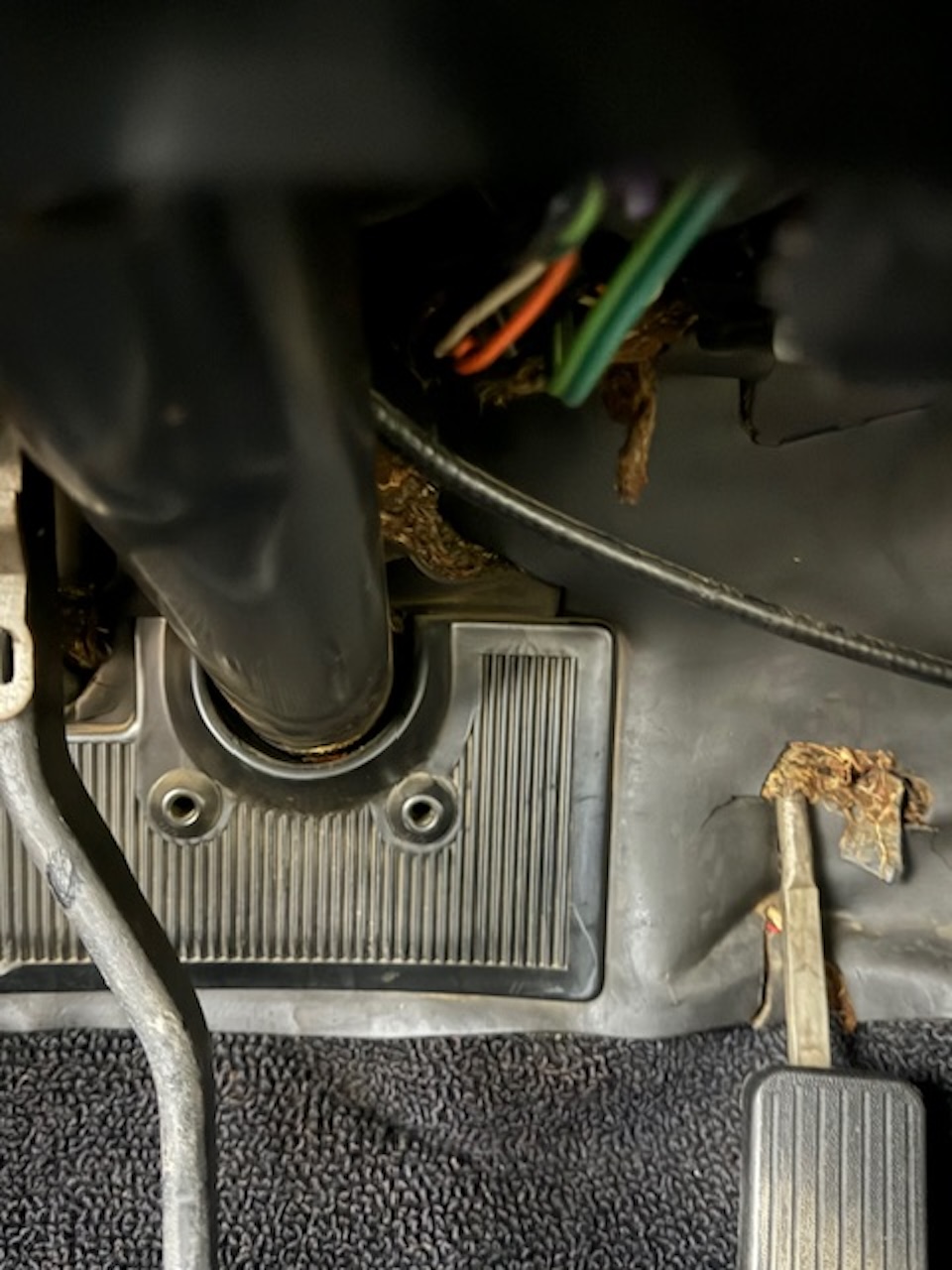

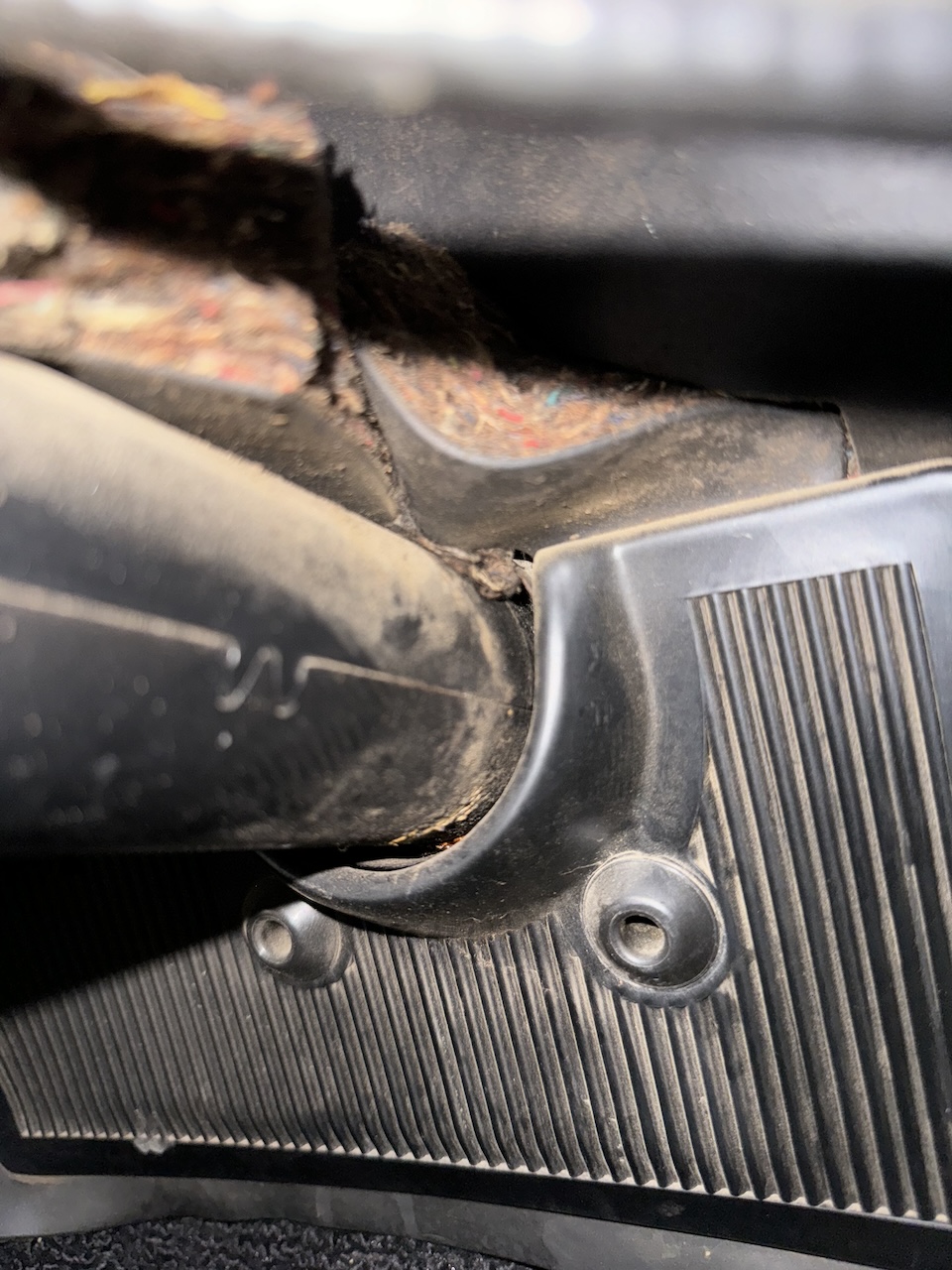

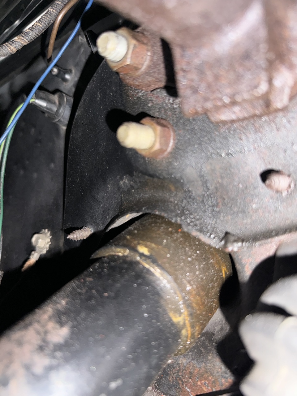

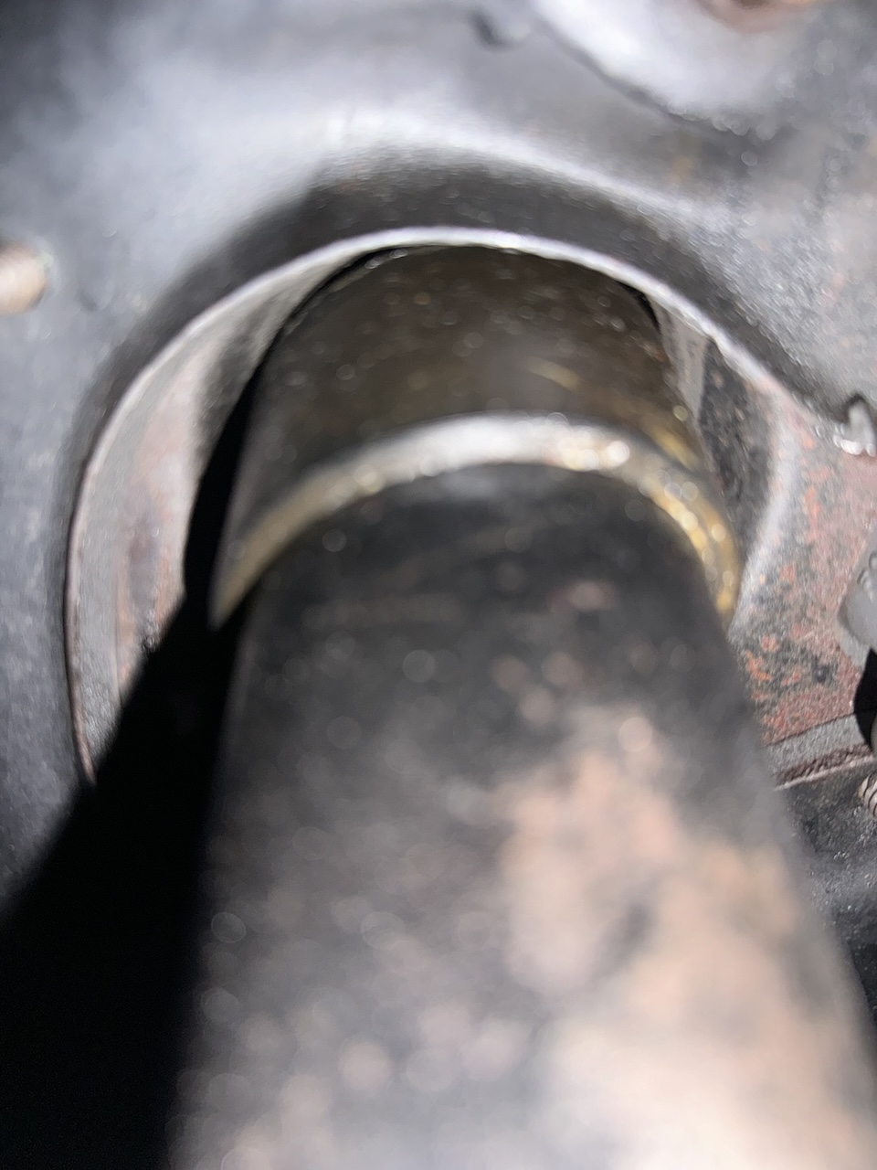

Pix from my '66 Mitch. Not seeing that bracket though?? On '67 it's an integral part of the firewall hole cover plate.

Thanks Bill, I don't recall ever seeing the bracket on the outside of the firewall. I have a couple other mounting plates that clamp the tube on the inside, but the AIM shows them for different columns than a floor shift one.
Did you look at the inside to see if you had a large rubber cover over the mount ?

Pardon my 58 year dust accumulation...

Thanks Bill, it's just as a I suspected, only the carpet guard. I've never come across a "grommet" in that area.
Once I get the bracket from Steve and see if it fits and would help secure the column, I'll be ready to install it back in the car.
