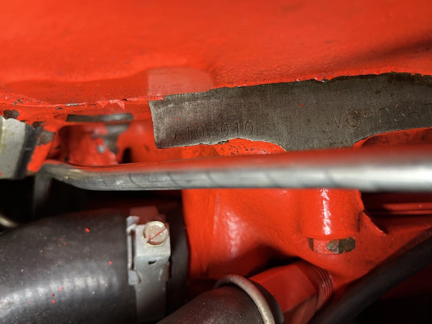

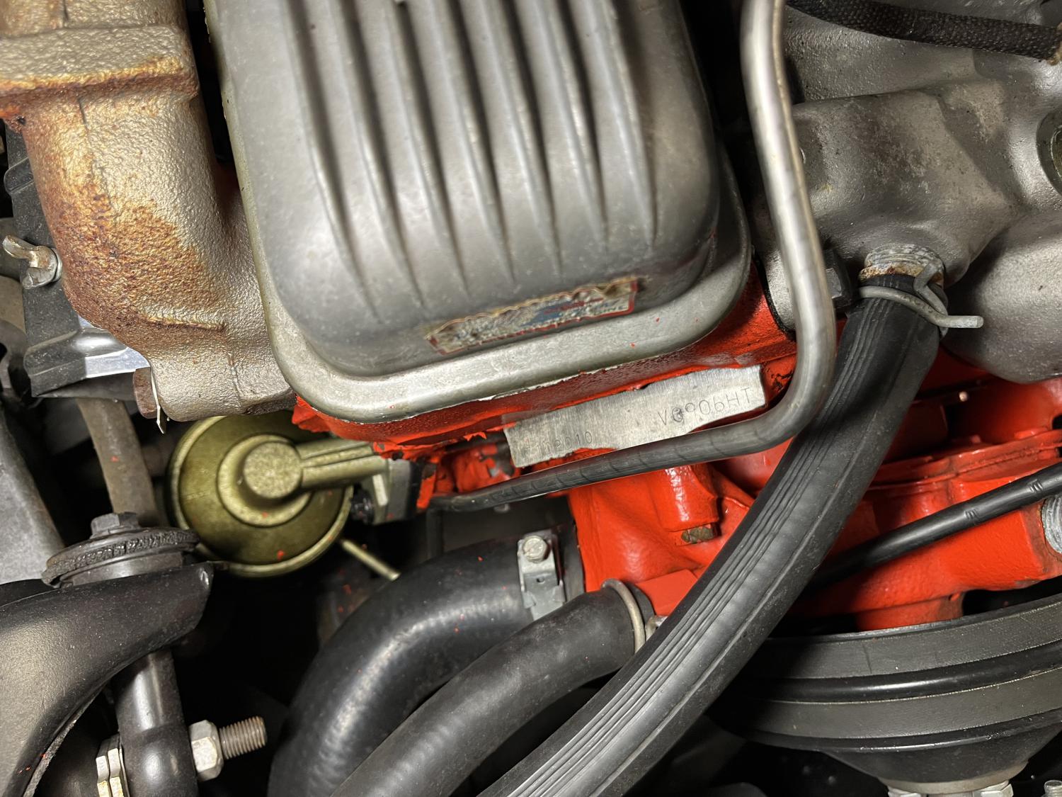

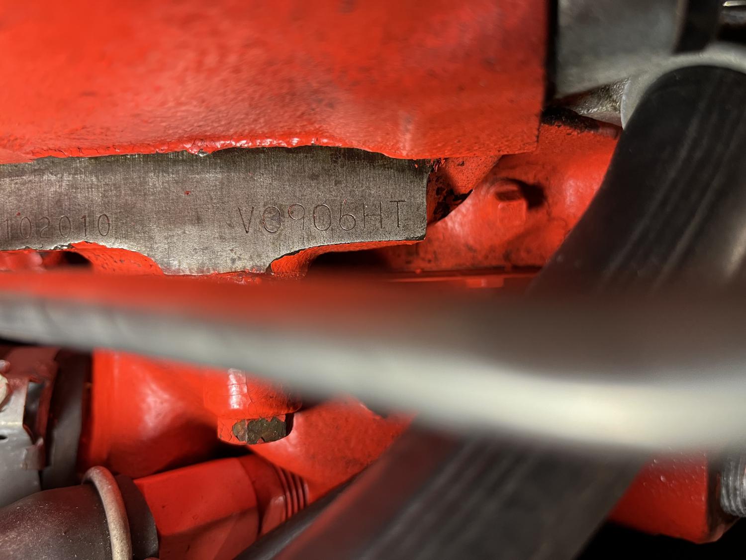

Hi all, Wanted to get opinions on the pad stamping on this L79 car.TIA,Rob.

I don’t think so.

Agree with TG!

Agree. NG

Agree with TG, MG and JM...NFG!

Definite stamper.

Not original but good example of what ‘Numbers Matching’ actually is.

Not typical factory production

Whoever put those broach marks on there (likely with a belt sander) purposely tilted the sander to the rear of the block to create that slight slope on the pad. Fairly common practice to tip downstream buyers it is a stamper.
