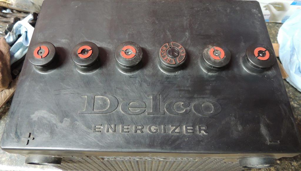

I think this one has finally bit the dust. Although, it was significantly low on water. So, while I am contemplating what to do, I filled it with distilled water and have it on the tender.
Will see if it comes back.
Bought it 18 years ago. Kept it in dry storage until 2012. Filled with acid and charged it up. Guess I was lucky to get 6+ years out of it.

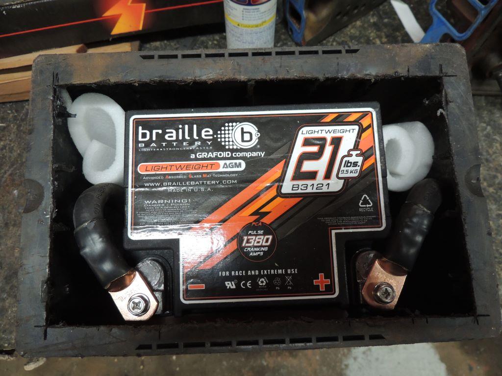

Here is what I am thinking of doing. Tell me if it is a really dumb idea. When I relocated the battery on my Opel GT, I used a Braille battery. Lightweight small battery with lots of power.
Thinking of gutting the R89 battery and inserting a braille battery inside. Not even sure how to do it. I guess the first step would be to empty the acid into something safe and figure out some place to safely dispose of it.

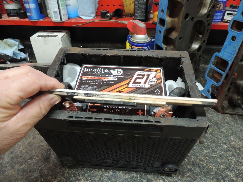

The repop correct battery’s have a small odyssey type inside the case, use one of those vibrating blade tools and cut around the inner edge, the odyssey is held down with epoxy, it pulls down so you can unhook the cables from the battery and retook them to the new Braille , yes they are expensive, like $200.

Just went and looked at the Braille in the Opel. It is 21 pounds.
part number is b3121, 892 cranking amps, so I doubt it would be an issue using it in the Camaro. Jegs sells it for $229.99 with free shipping. Not cheap, but less than the repop from Rick's Camaros.
Mine has the positive on the left side. The B3121 on Jegs shows positive on right side, but I think it is available either way.

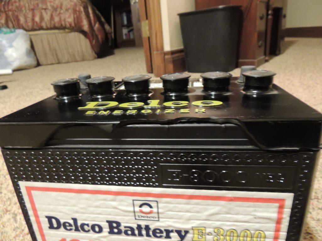

Ryan: I have a very cool E3000 Y59 display battyery (no guts) circa 1974. I bought it in the 90's. Just thought it looked cool. It would be great to convert to modern mini battery power EXCEPT, about 10 years ago it fell off the shelf and the top broke along the back edge. Pics show the damage. It is a shame, as it would have made someone a great modern battery.

More pics.
