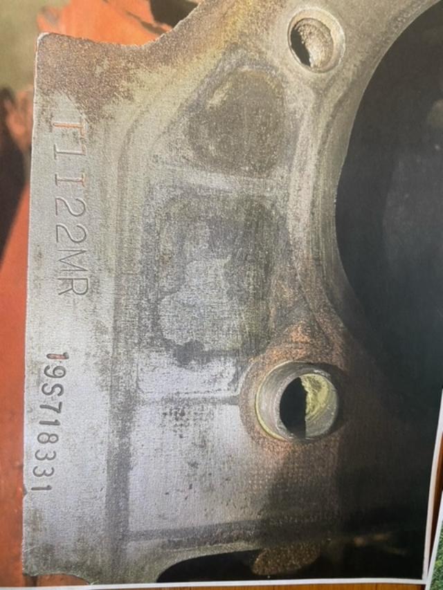

Probably a reason he doesn't show the engine pad stamping ?

Here's a picture of the block stamp. A friend WAS contemplating the purchase. His NCRS connections told him the VIN is for a March 69 build date car, but the block is stamped November 68. He's a hard pass on it.

Have a friend that WAS dealing on it. Here's a picture of the block stamp. His NCRS connections say the body VIN shows a March 69 build date, but the block was stamped November 68. He's a hard pass on it.
That's what I love about you guys. Y'all can't be bullshited.

The '69 L78 chevelle with born with engine was cast in march with a late June assembly on the engine.

A spread like that may not be the kiss of death for an L88. It may have sat around for a few months.
