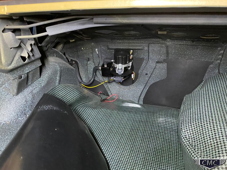

Sharp car with what appears to be the original dealer invoice, but the quality of the pics is garbage. Anyone familiar with this car? Asking price $85k.

Pad is a restamp.

Those exhaust manifolds..

The front headlight doors and grill fitment are awful. Probably a cobbled together car.

I believe I looked at this car several years ago in Minnesota. the owner had died and if you were interested in the car you had to write down what you were willing to pay for it and hand it to the wife. it needed a full restoration. I don't remember it having the original motor.
