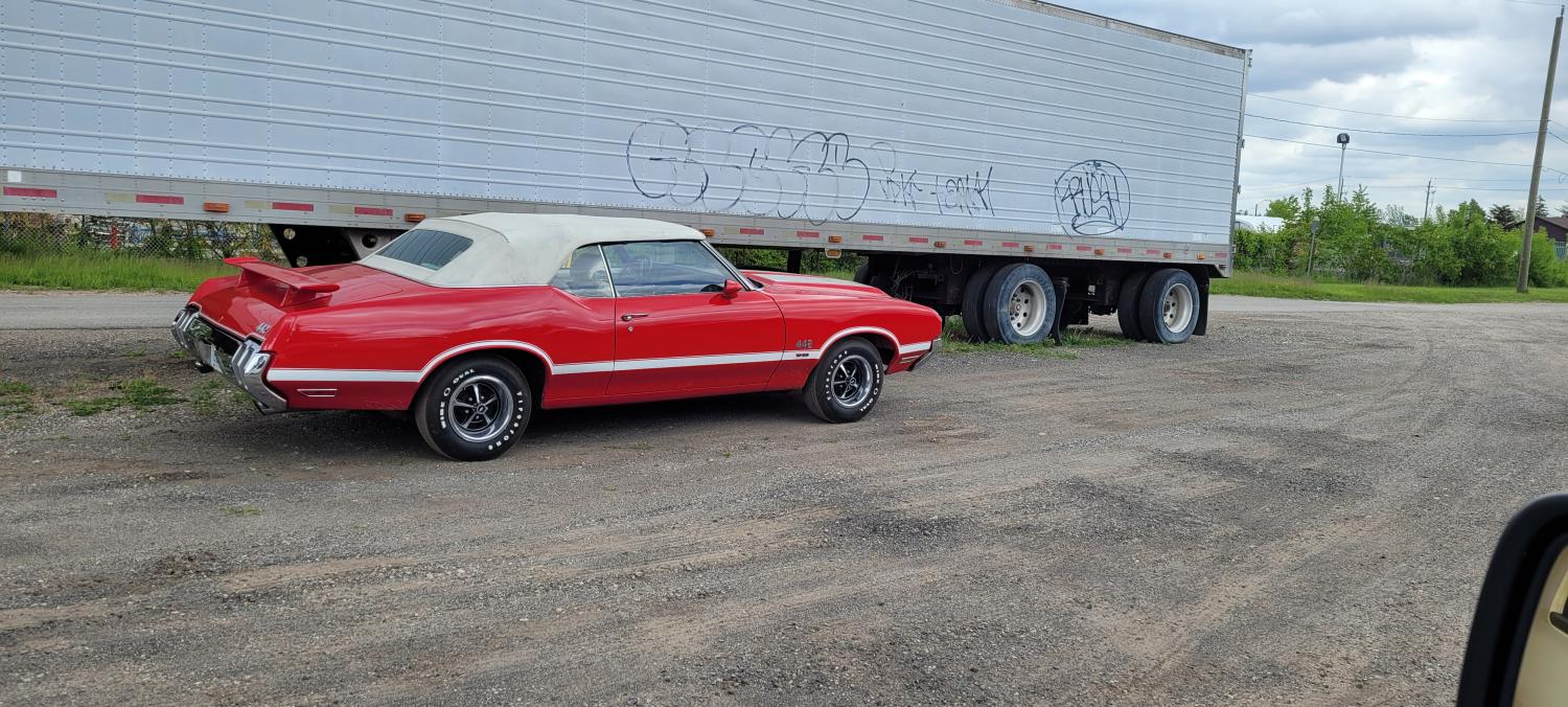

Just wondering what is tge best product to use on a white convertible top that has some black marks on it? Bought a car and would like to get tge top looking better.

Thanks guys. This is the 70 W30 clone I bought. Top is just showing the marks of a white top does over time.
Will look into the magic eraser, bath or kitchen one to use as I have both. Maybe try some Dawn dish soap. Have to research the Westleys.

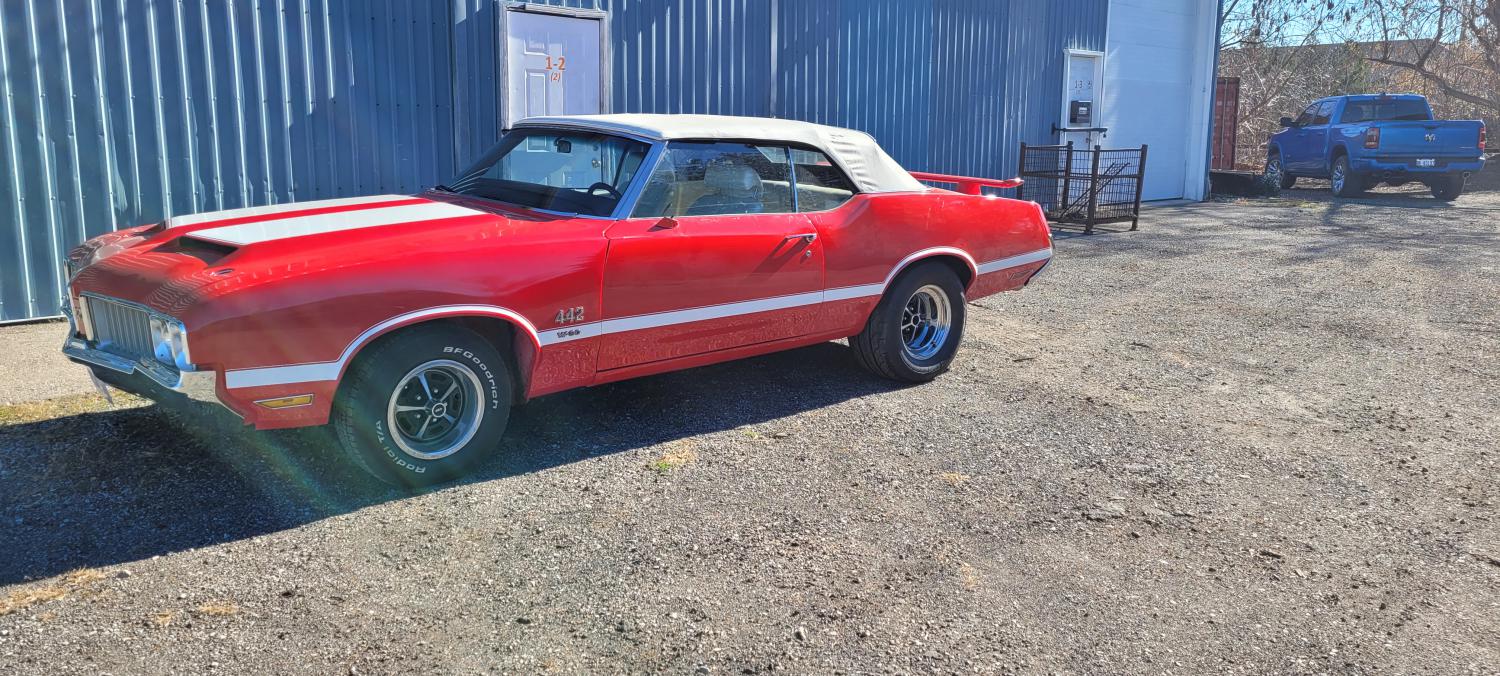

This was last fall just before it went 8nto winter hibernation. Also test fitting the new rear rin/tire combo.

Beautiful Cutlass!!
