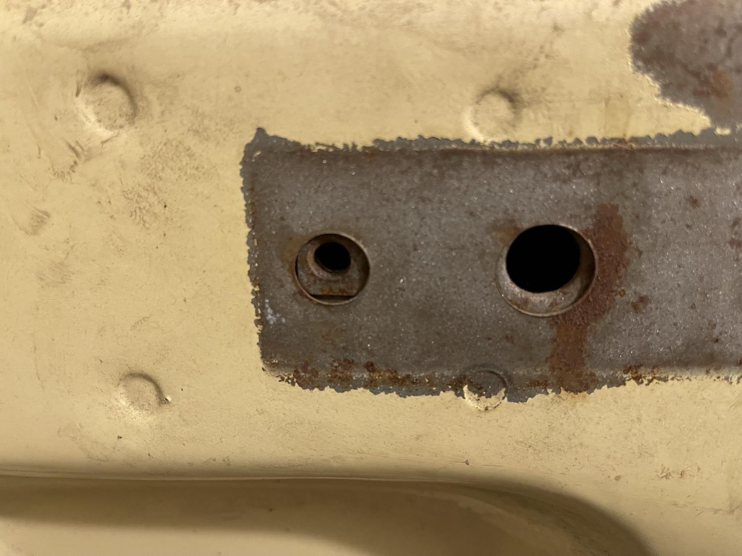

Guys,
Is this a '69 decklid (I see the tabs along the rear hem flange) with a 67 emblem? Do the '67 and '68-9 decklid emblems interchange?

Try this, Looks like it my be 67 as there is no provision for the new emblem, can get con fusing , but study the photos at tha CRG
http://www.camaros.org/exterior.shtml#trunklid

Its a 67 3 hole Deck Lid. Rob Rictor "RobR" is looking for one if you want to sell it. He is a member here and a nice guy. The emblem is 67 only....68 69 emblems are interchangeable

Thanks...bummer. Would it look way out of place on my '68? Any way to gain access to the relocated spoiler emblem position? Does anyone know if the emblem pin locations are the same between '67 and '68-69?

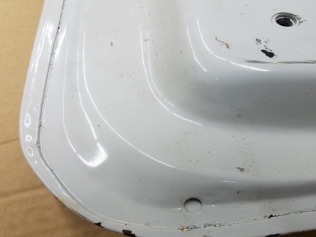

I have a 1st Gen Camaro Deck Lid......
1) Painted White on Inside but still Black Primer Out
2) No emblem piercings
3) No date codes that Ive seen
Can this be any form of GM/OEM or is it Aftermarket ?????

It is aftermarket I believe judging by the hinge holes/threads.

" It is aftermarket I believe judging by the hinge holes/threads "
OK..............Waiting for more thoughts/opinions
Square nuts are visible inside hinge holes on GM deck lids. How well does it fit?
My guess is someone painted underside then installed and found out it fit poorly.
67 Convertible T-1

The picture speaks for itself!
Your still waiting on other opinions?............. Gl with that.
Oh, and your welcome.
