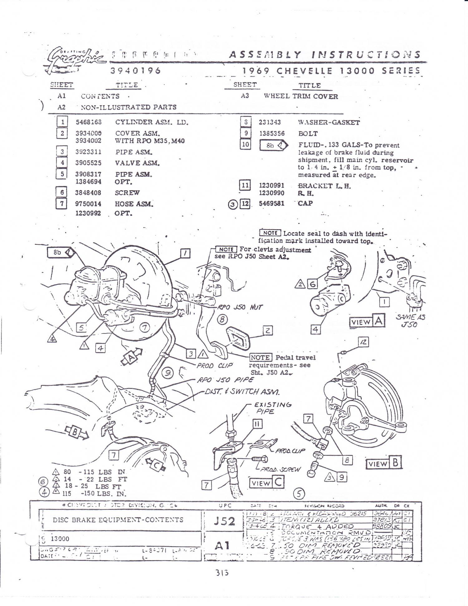

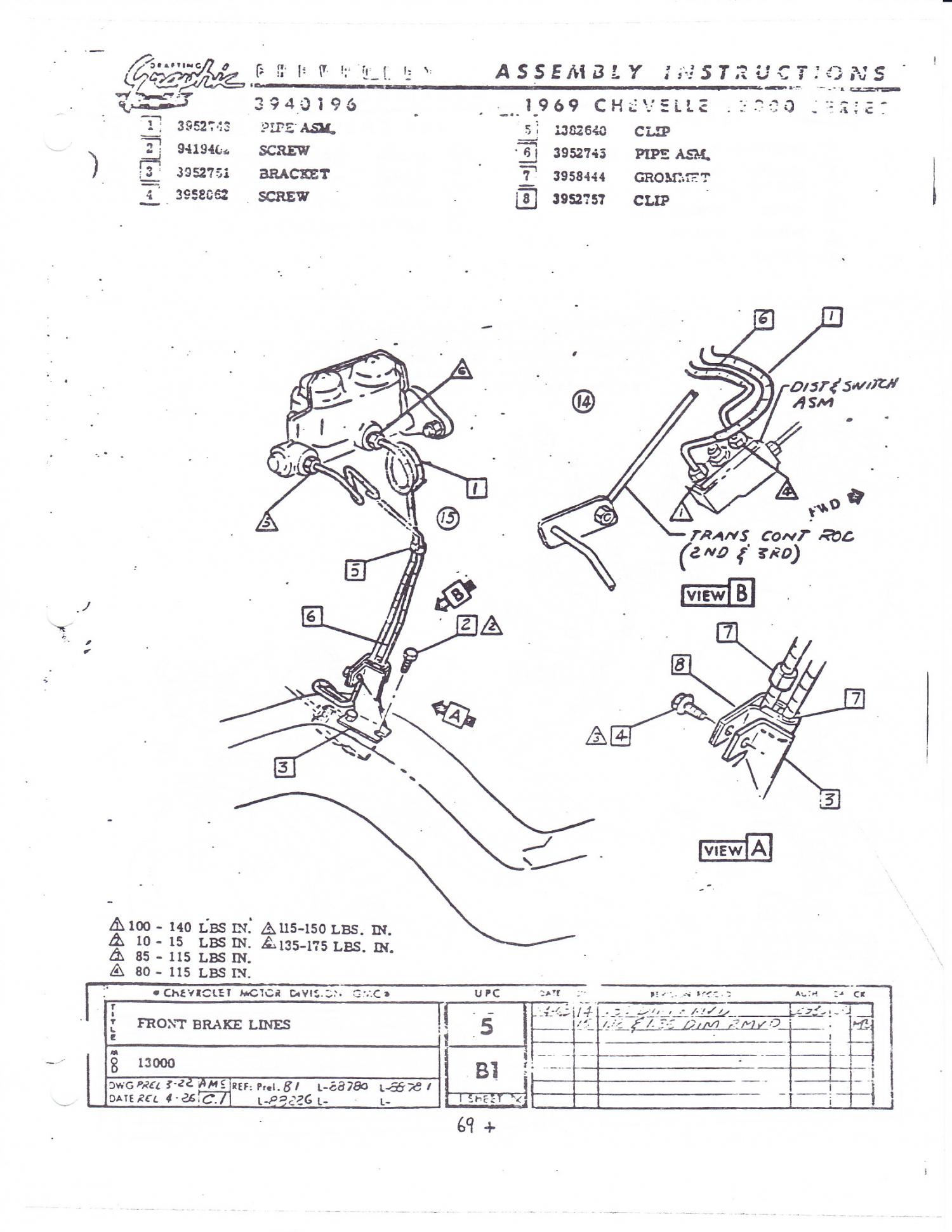

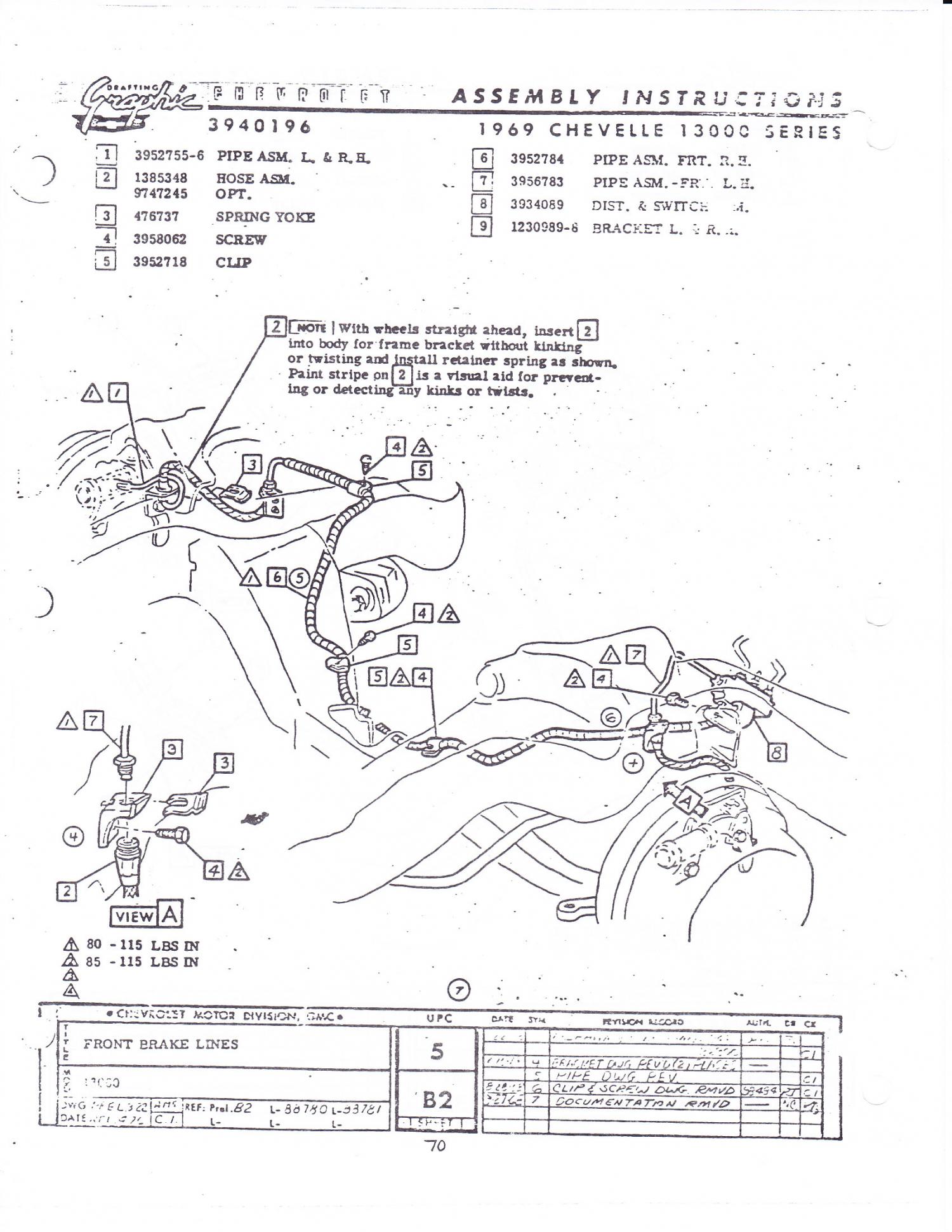

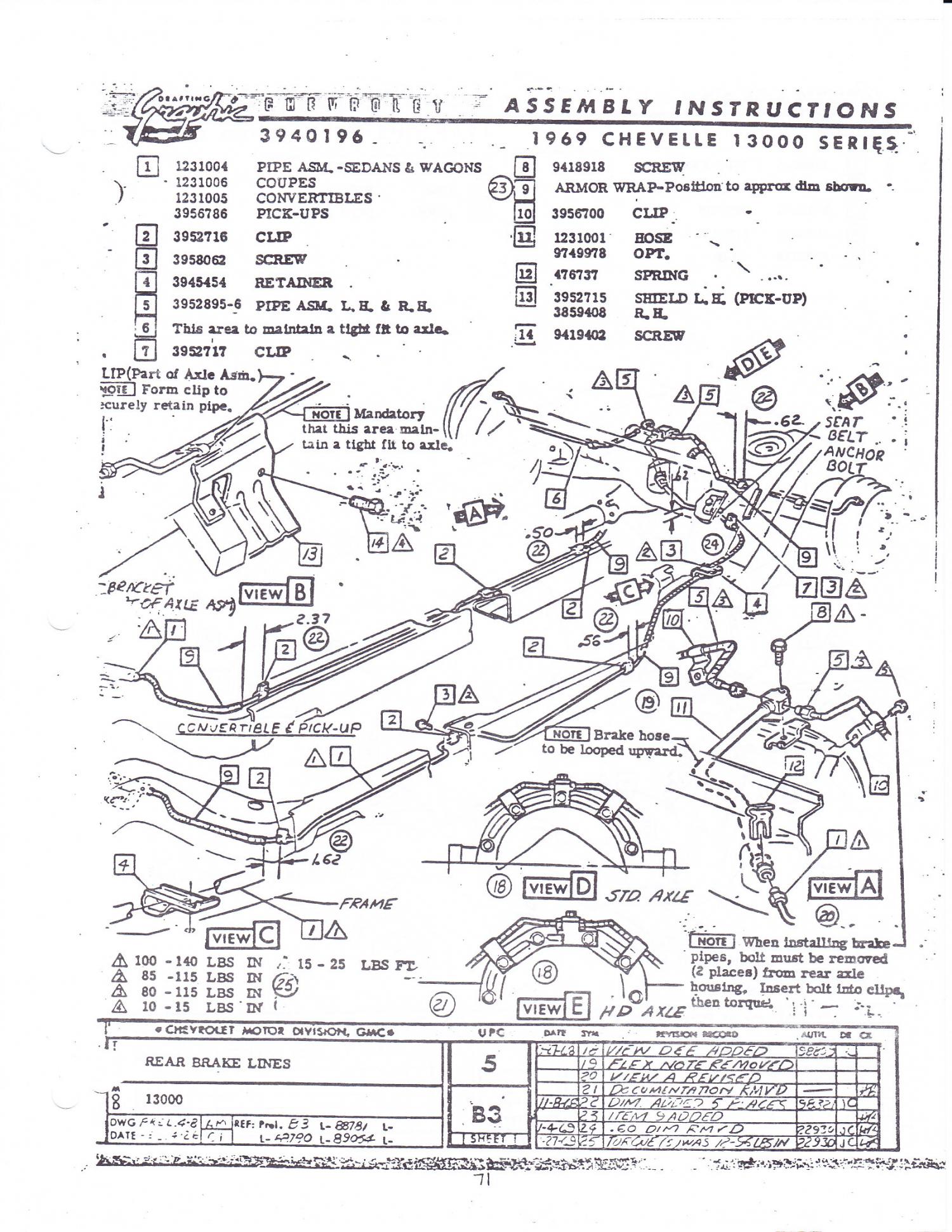

Need a diagram showing the proper routing for brake lines on a 1969 Chevelle SS96...especially interested in all the lines from the master cylinder to the front and rear wheels. Trying to help a car buddy make sure he has all the plumbing correct.

Is this what you want?
