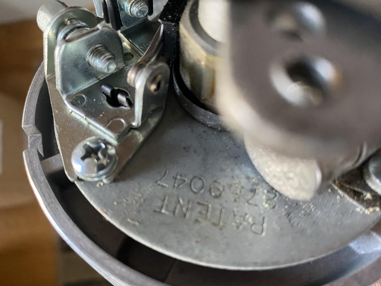

This looks to be nicely restored.. Any experts that can tell if this real or a restamp or not? Thanks in advance!

Hi, I am confident in calling that 1111499 stamp fake.
Sorry,
Anthony

Anthony is right

Yup.

Thank you all! Good thing I didn't pay much but was hoping it was real of course...

Measuring across the diameter of the distributor in the area of the stamping, you should read between 3.819 to 3.813 inches.

Clearly NOT an original stamp.

Wow....more than one red flag there.

Thanks again everyone! Now I'm wondering if this one is actually a re-stamp. Bought it 20 years ago on Ebay and have listed here for sale.. I'm trying to learn here..
Looks real to me too,
