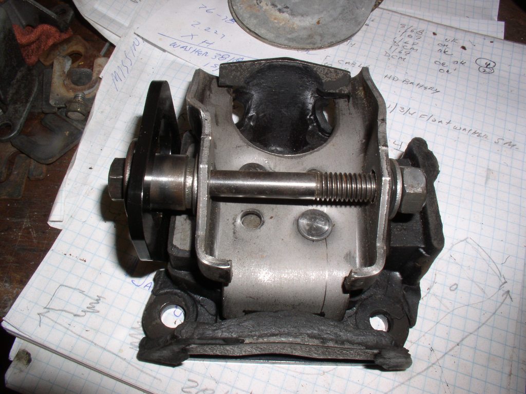

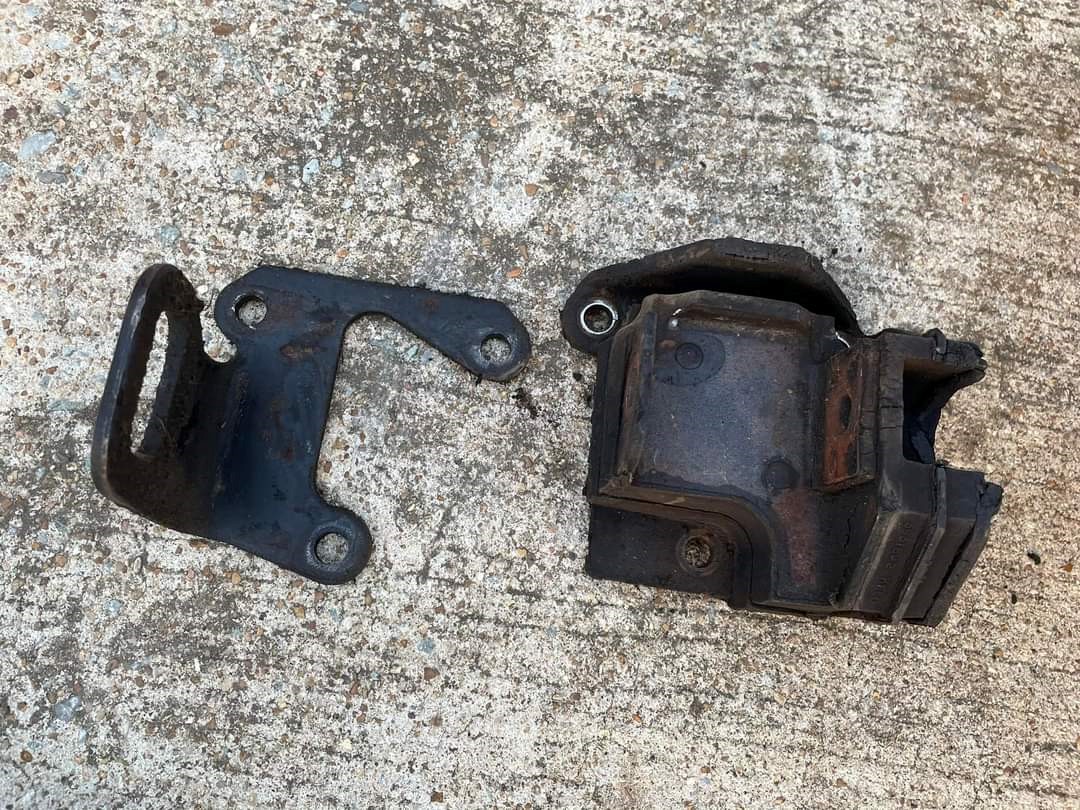

wondering if this was a production mount or when in production it started? I've never seen these in person - also any info on the bolt and spacer would be appreciated

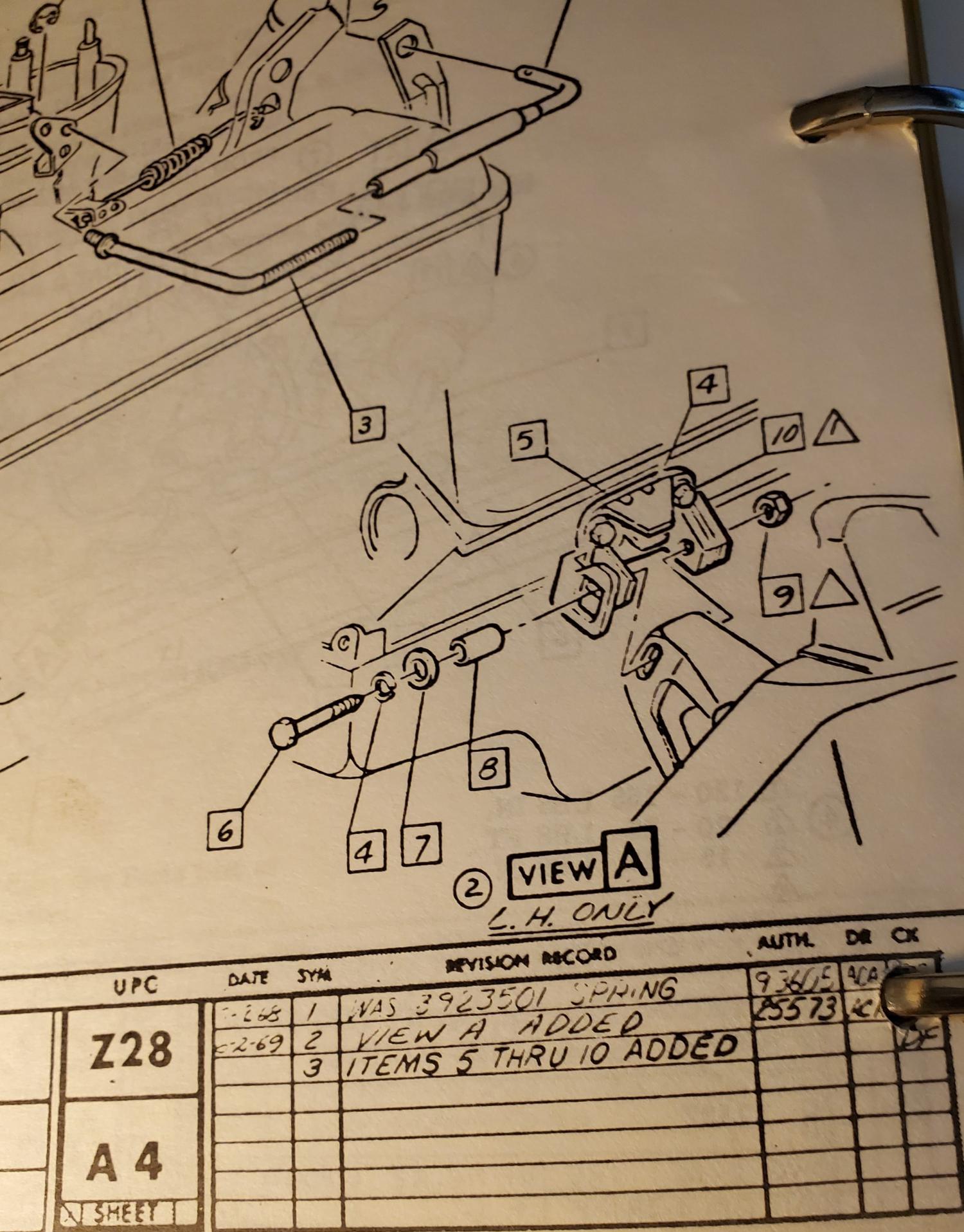

That bracket is on upc Z28, sheet A4 in the AIM. It looks like it was drawn 8/2/1969. My 8/28/1969 had that same system even though it's a 396. Mounting bolts to the block are a thread or so longer on the driver side...Joe

THX X66 I saw that Heartbeat offers repro brackets for SB and BB but not the correct mounts, the longer mount bolts is understandable but I was curious about the long through bolt and spacer, washers any chance you can post some pics up? I'd love if anyone has dimensions available of spacer - length of through bolt OD of washer and thickness ect

I cheated a little because I didn't want to spend 1,500.00 plus on original mounts. A copo, i would've. You have to put a bevel on one edge of the mount where it meets that bracket. I got the bolt from Rich who used to sell hdw here. I might have to take mine out to replace a freeze plug. Here's a picture of that I did. Real pieces are hard to find...Joe

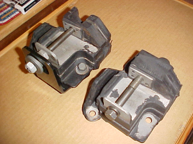

There is a post on CRG i was involved in regarding the original production mounts. Here is a picture of a original set of Z28 mounts i have, lift plate is a reproduction.
cool and I forgot to look on CRG -older age is great isn't it? -I found the thread there, was hoping for some measurements of through bolt spacer and washer if its handy? I have also reached out to Lloyd Edgemont as he was looking I'm pretty sure he has located it by now
