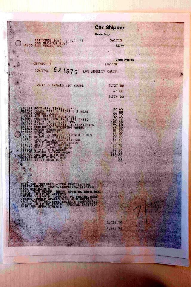

https://www.ebay.com/itm/16548354696...0AAOSwhC5igUXP
124379L521970
From the ad:
Up for sale is a very straight, solid, original SS Camaro. This is not a clone. It comes with the original build sheet and window sticker.
Paperwork is repro, as noted when it was on eBay September 2015. I'm certain Chevrolet would not misspell Los Angeles.

Heres the shipper report

2015 CRG thread also noted TT Body # different than fake paperwork.
Hard to believe how people spend $ like this without at least Googling the Vin?

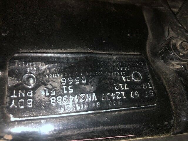

The number 244988 on the tag establishes that the paperwork is fake; it should match factory paperwork. 361713 is from a much later car.
