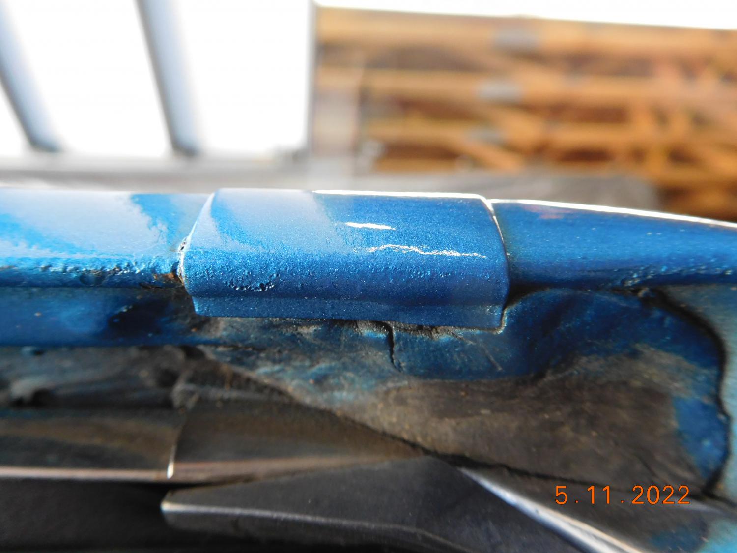

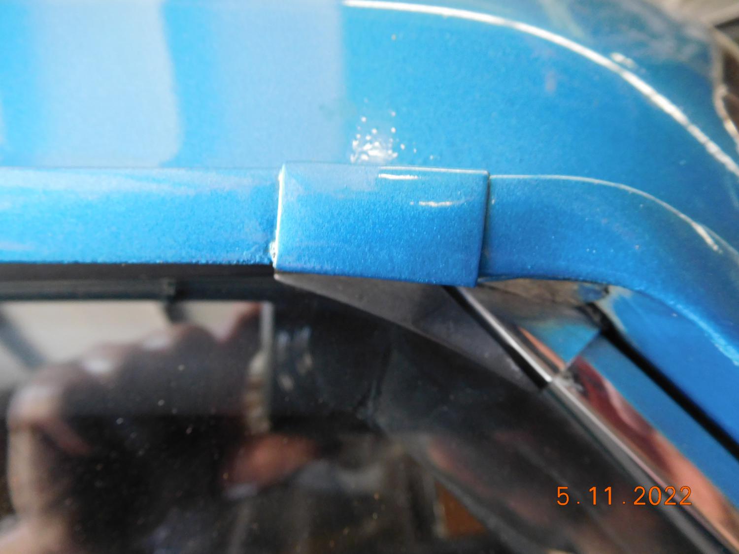

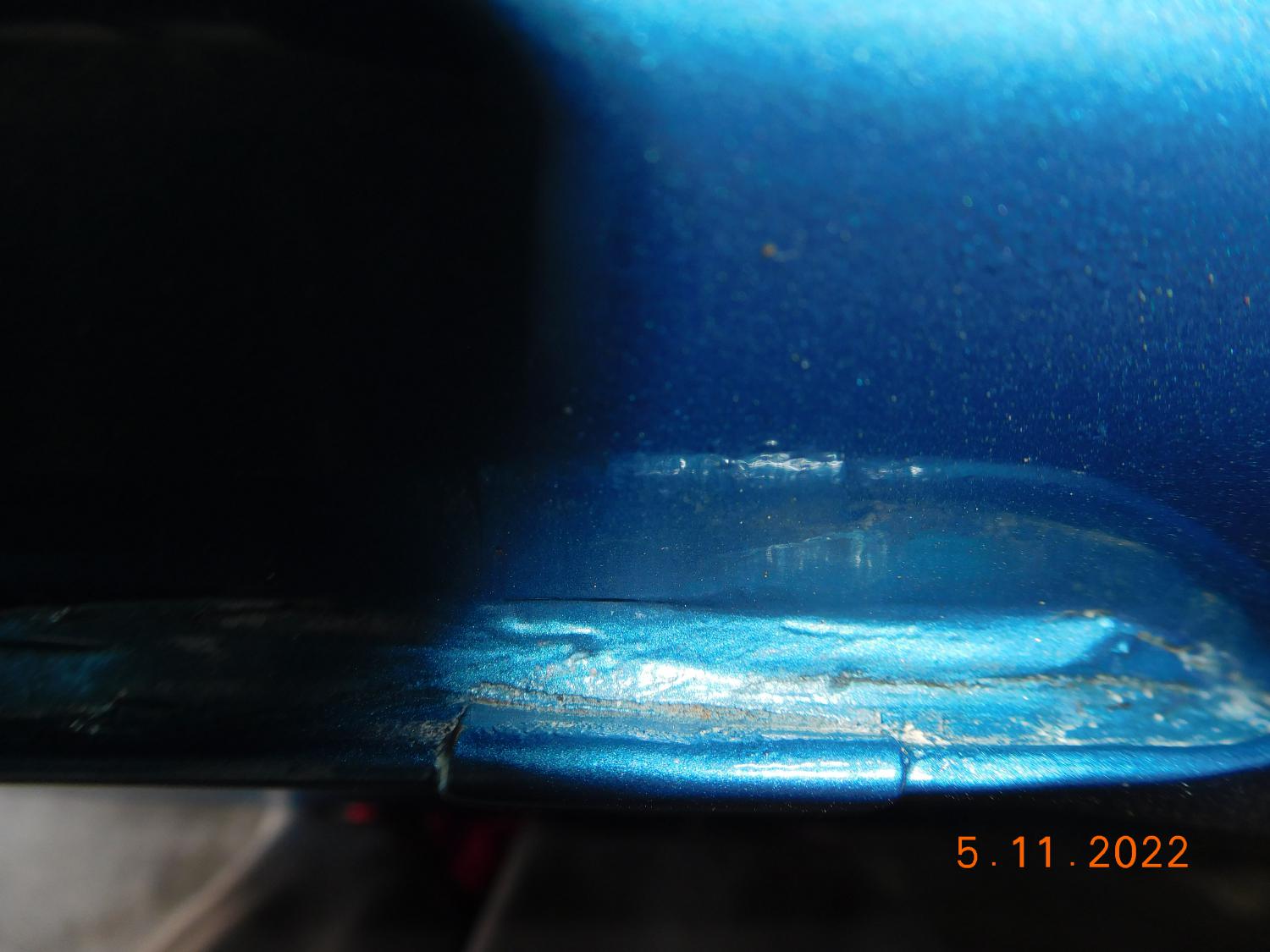

Anyone got a few pics of one installed? would like to see both the top and bottom side of drip rail viewpoints. Held mine up this morning and the fit is very loose.

I can get a pic of mine tomorrow evening if no one else steps up.
Pretty certain they need to be installed before the sealant and the paint to look correct.
