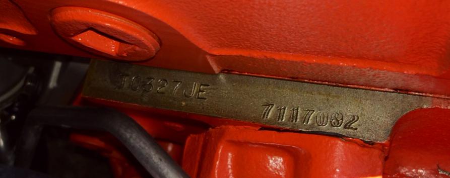

I'm curious about this one I know some strange things happened in the factory. It appears a gang stamp was used and the numbers have consistent spacing. Could this just be a factory double stamp? or someone trying to hide something?
Thanks Steve

Gang stamp,not gain.

My SD455 is double stamped from the factory.

----Do you have the opportunity to take the paint off the tab? My old eyes would be able to help more. We need to see the broach marks as well!....Bill S

Double Stamps / bounced stamps in themselves are not uncommon. I have seen 2 and even three of the same stamp, once on a transmission.

I have many, many double stamps in my pad library, this is one of my favorites because you keep trying to focus on it as it appears blury. This is a confirmed original stamp correcting a 9 to a 6. It should have been ground and restamped correctly.

I have many, many double stamps in my pad library, this is one of my favoirits because you keep trying to focus on it as it appears blury. This is a confirmed original stamp correcting a 9 to a 6. It should have been ground and restamped correctly.
Out of curiosity, how do you confirm a double stamp?
Thanks
Old 04-20-2022, 12:44 AM
TimG TimG is offline
Join Date: Sep 2001
Location: Austin, TX
Posts: 4,707
Thanked 2,826 Times in 1,096 Posts
It would go through a Regional or National NCRS event or Bloomington Gold. Any stamp with a question will go to a higher authority. They would look at stamps with an exact same build date and assembaly code and look for VIN numbers surrounding the stamp they are looking at.

Tim are you familiar with cranes corvettes .The w on the first post is different then others i have seen.

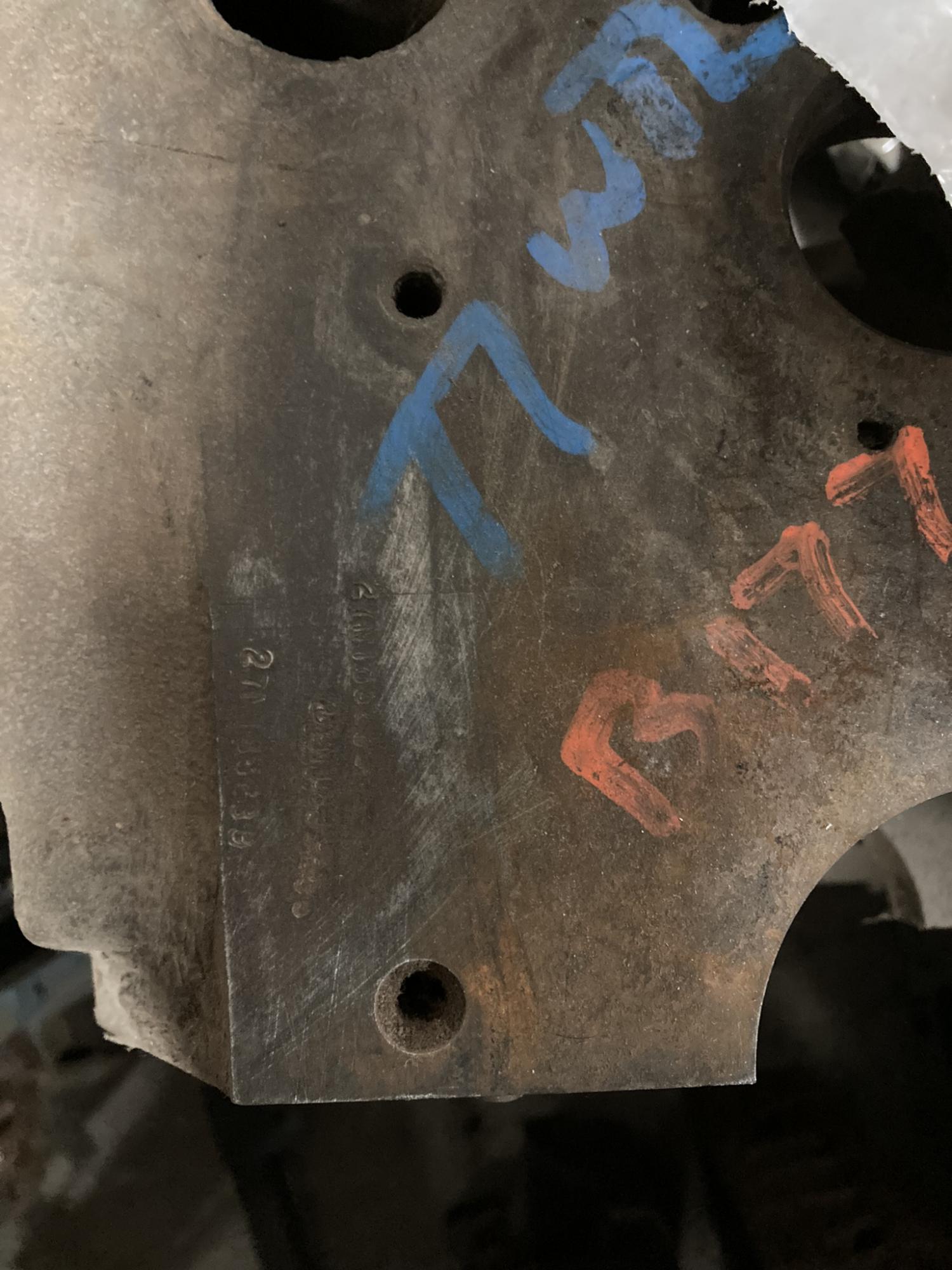

I’ve got this block out of one of my cars. Must have been the new guy.
