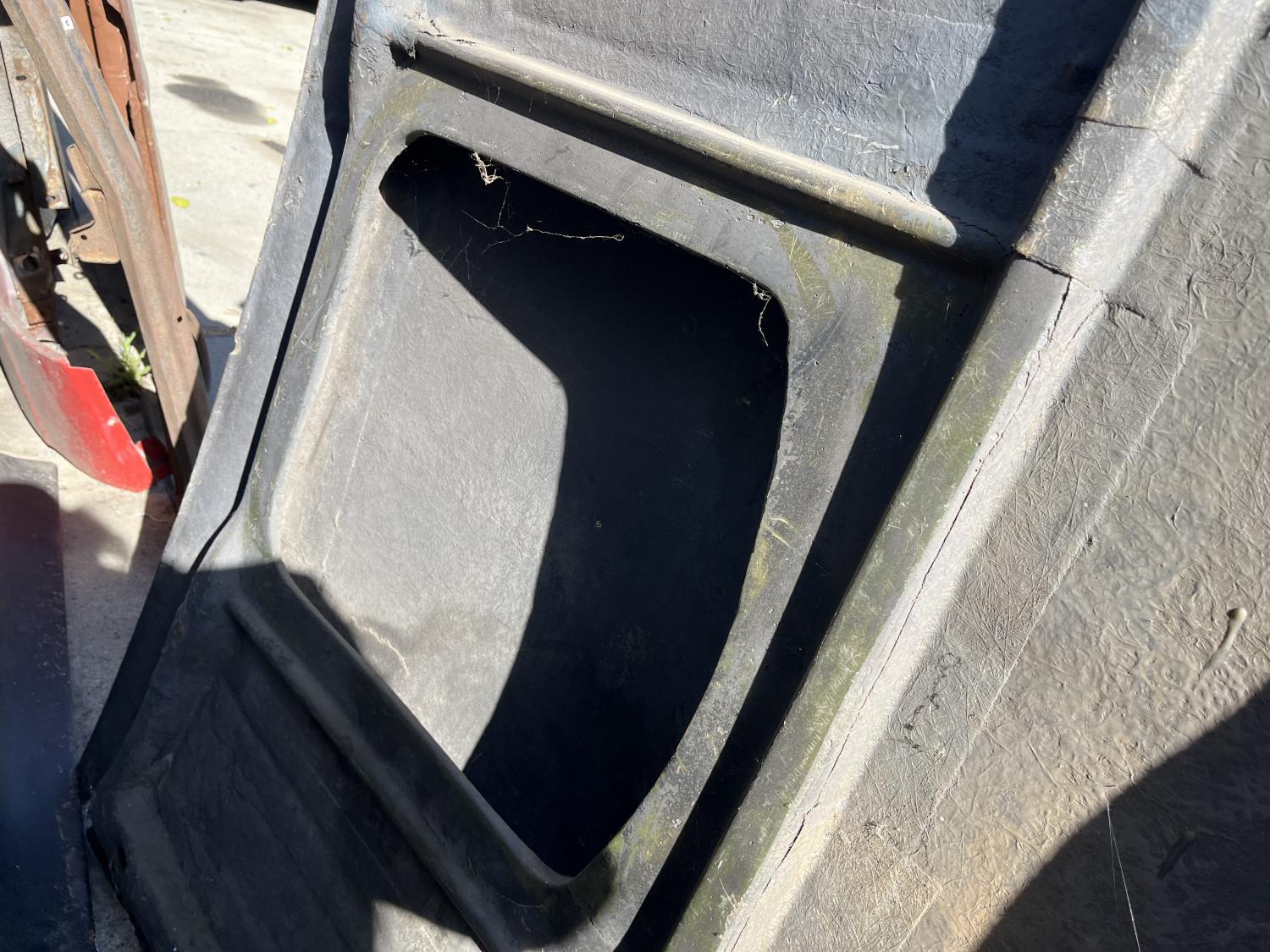

Hi Gang,
I don't know a whole lot about MoPars, but I stumbled across this and was wondering what you folks thought about this hood and if we could guess at a value.
I've been promised it's an original 1969.5 factory piece and from The Google I think it might be with all the evidence of green fiberglass et cetera.
But it's far from perfect and might be pretty rough - the center divider is gone and the corners are beat; this six pac A12 RR hood looks to have been bouncing around for years / decades... I cannot believe these are too common.
Any opinions welcomed on:
1. originality
and
2. value
Thanks in advance everyone,
Anthony

I'm not a Mopar guy but I don't think the 69 6-pack cars had that bulge running to the front of the hood shown on yours. I'm sure someone with more knowledge that me will chime in.

The underside actually looks right, but topside the scoop opening does not seem near big enough and what happened to the divider? It isn't there.
Yes, the A12 Road Runner had that bulge.
The only ones I see on google search with that wide bulge are at dealerships. that was 2 cars of 30. The rest have a the thin bulge.
Thin on the Dodge Super Bee A12, wide on the Plymouth RR A12

From The Google, I think that's the difference between Dodge & Plymouth... thin v. wide.
