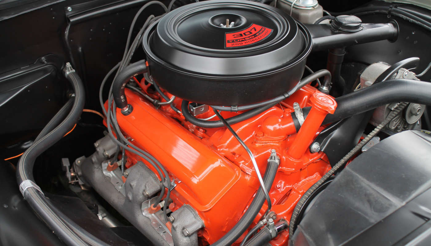

Here is the photo I originally posted.
No matter what EVERYONE should remove the ink jet coding on the newer style hoses... they didn't use that type of printing in the 60's.

Thanks for the picture but that's an open element air cleaner, I have a closed.
