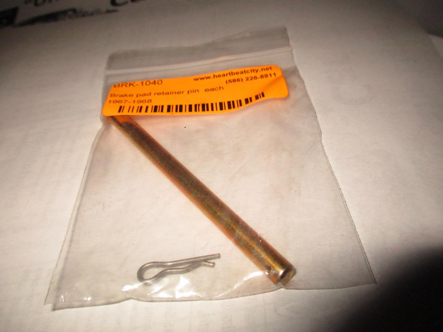

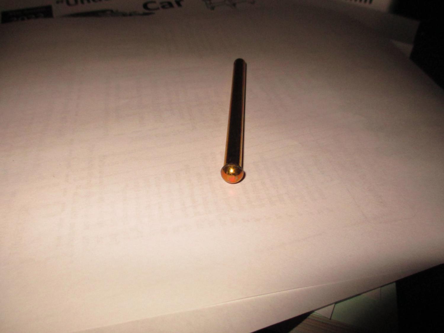

The original pins are around .960 in dia and the repos are around .930. The head is different
then the originals like you said. If you have the pads, they they should be in there. The cotter
pins are silver. (Originals) The Repo ones I have are from Heartbeat City.
The repos are gold plated as stated, these are my spares.
Dave
