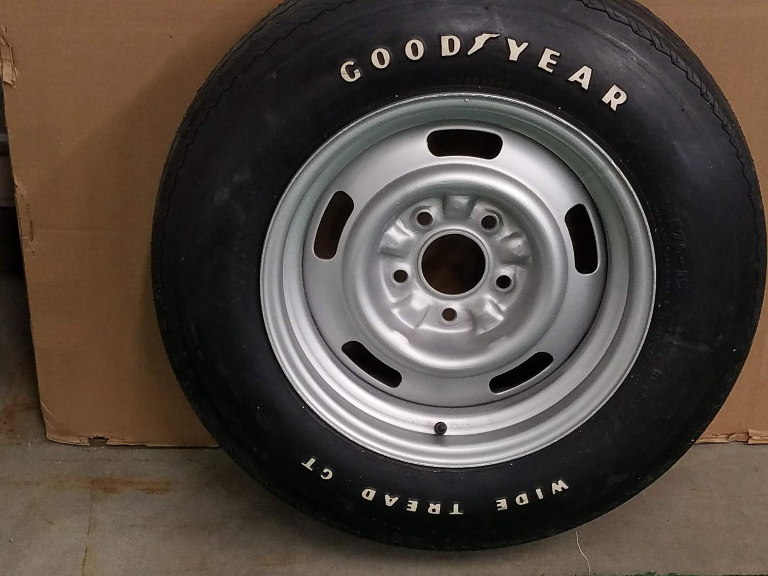

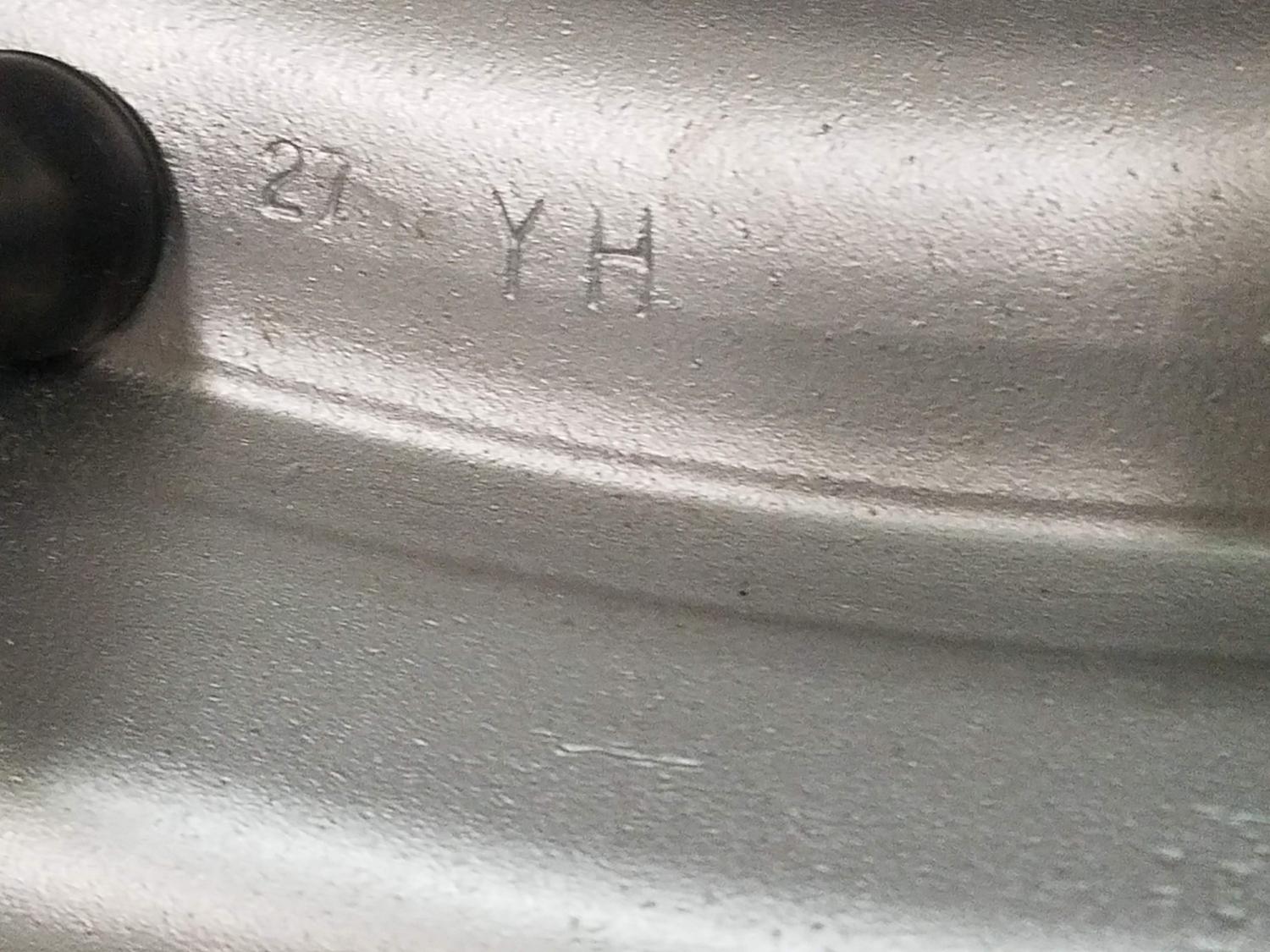

This is the spare tire in my 69 Z. Can any of you people smarter than me tell the date code?

First digit
66=M/Z
67=K/Y
68=L/T
69=J/U
70=E/W
71=H/X
72=G/S
Second digit:
F = March [Months are (from 1, Jan, to 12, Dec) T,U,F,S,Y,N,P,A,C,K,E,R]

Thank you Lee. Makes sense it's an 03B car.
