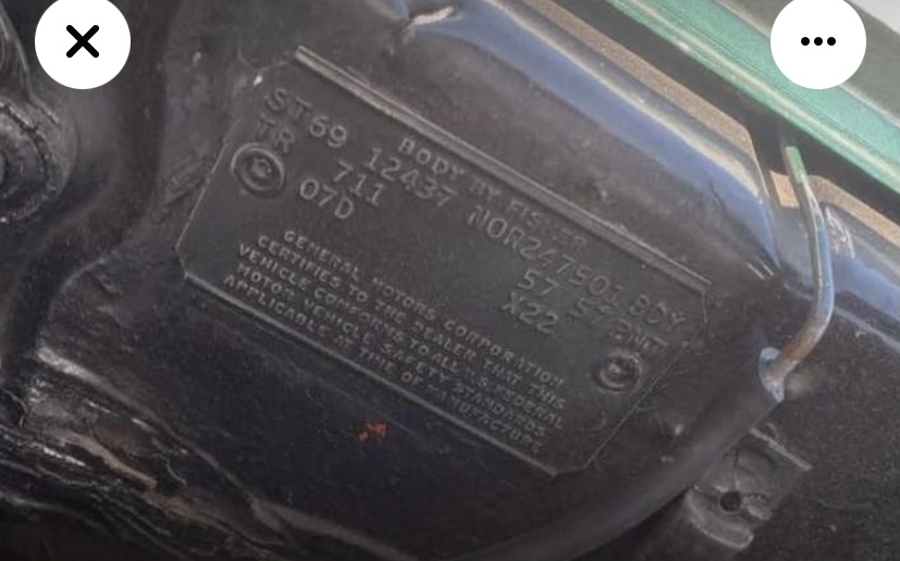

Found this car online. Is it a real x22 tag looks different than others I’ve seen.

Kind of hard to answer without more info or a picture of the tag.

Pic now posted.
Thanks

Isn't that body number generally associated with a build date of around 02A (1st week of February)?

That and the clumsy error. Obvious repro.

Wow to a very untrained eye, me, that looks legit! That’s why I leave it to the experts.
It it so disappointing the fakery that goes on

Can anyone confirm the Vin this tag is affixed to?

Agreed, poor repro.
NOR247501

Glaring errors if you know tags. Rivets are not punched either.
