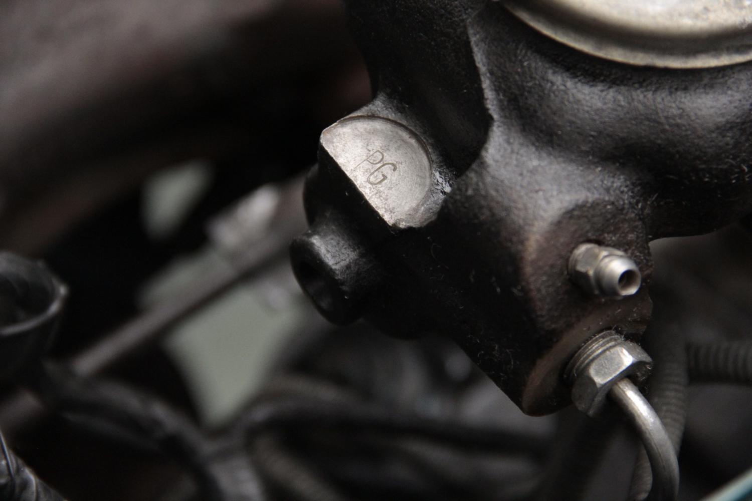

Here is the PG stamp on the master cylinder on my 71 Corvette.
Manual brake cars use a DC master - 67-early 72 is the same master cylinder.
Casting doesn't change after that however they are stamped on the first boss with the assembly stamp and date.
The machining or assembly date is on the first boss with the line coming out.
If there is not a jullian date (formatted: LAST digit of year followed by the day 001 -365) it is from a 67-69
