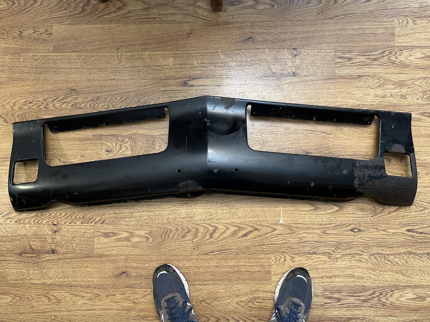

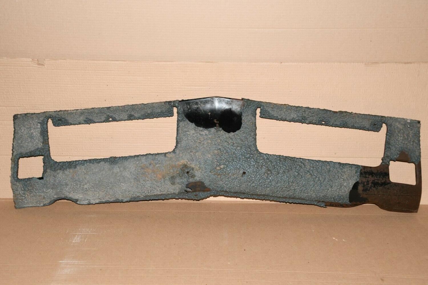

Sometimes I am amazed at the stuff on Ebay. I did the BIN on this piece 3 days ago and received it today.
After removing the factory rubber coating I realized what a truly nice valence this is for the price. It is a 67 nos lower valence with the early GM sticker still attached.

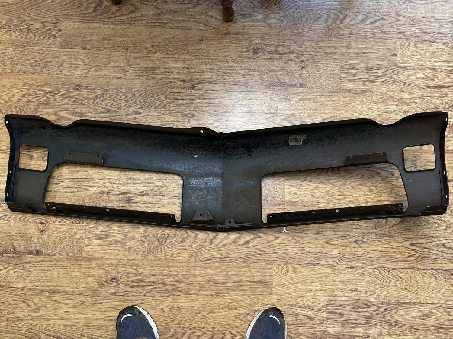

Front side still mostly has factory E prime but back side has mostly surface rust.
Maybe a good candidate for Ospho or the PPG metal cleaner and neutralizer SX579 that Chuck Burg mentioned in his Day 2 restoration?

Dang, nice piece. You don't happen to have an extra tail panel ??
You could use Evapo-Rust on that too and not need a neutralizer.

I don't have an extra tail panel, sorry. Yea maybe build a tray and soak it in Evapo rust?

Find anything big enough and line it with a rubber membrane. I lined a 144 gallon stock tank with rubber roofing to soak fenders in.
