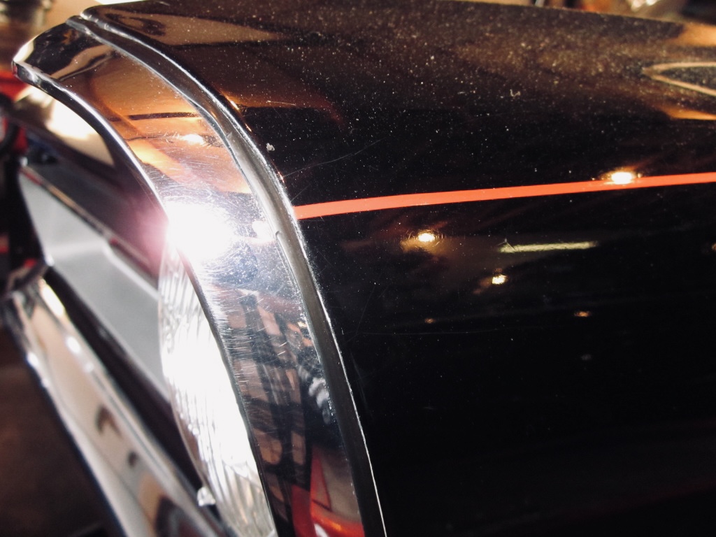

Hand painted pinstripes shown on Mr. Seymore’s ‘65, Pontiac plant build (09A).

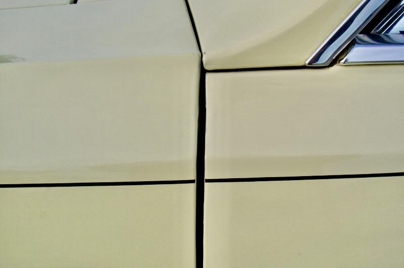

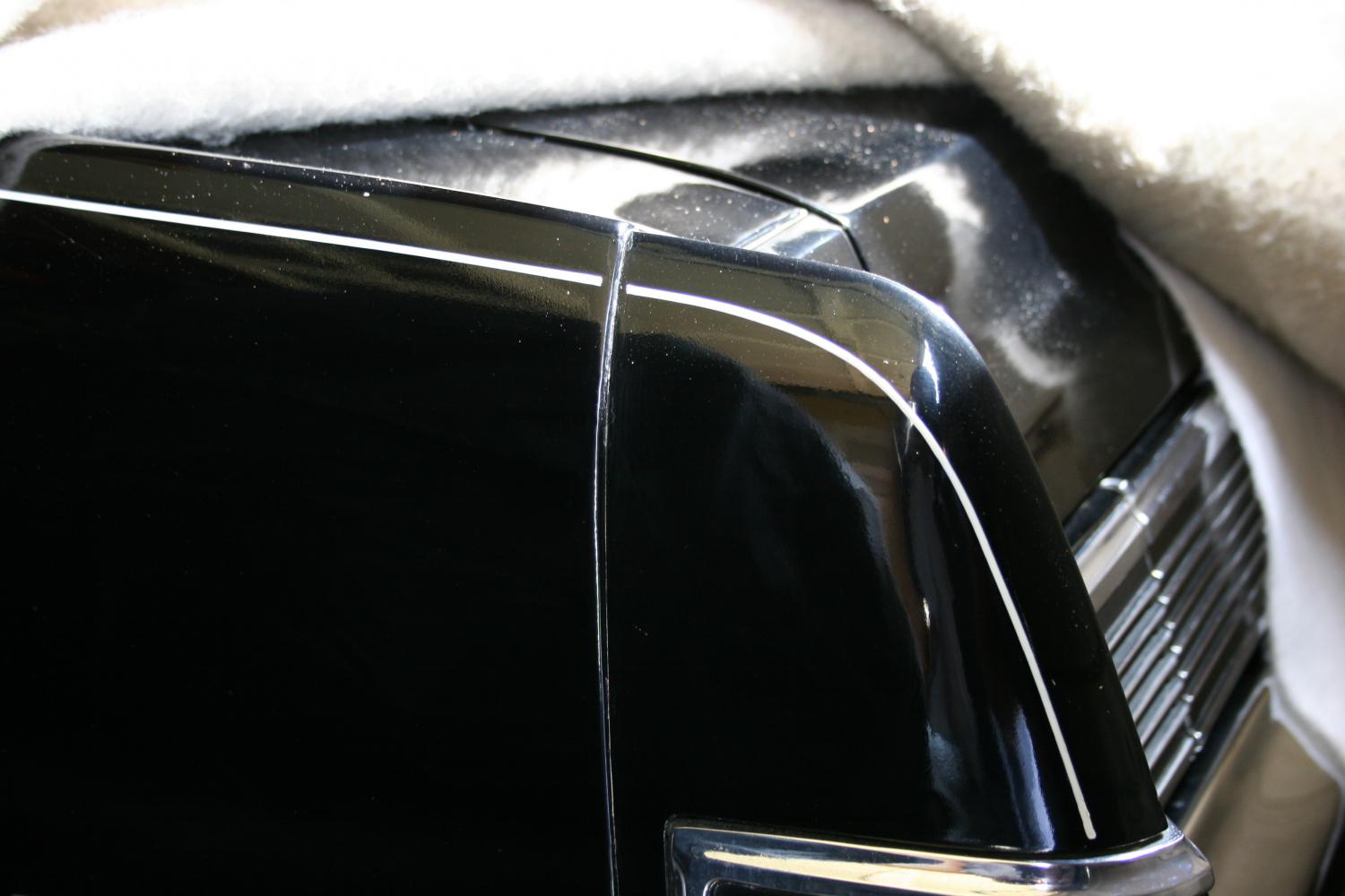

Two Baltimore build GTO’s using the Beugler tool.
Mayfair Maize (11A).
Starlight Black (12E).

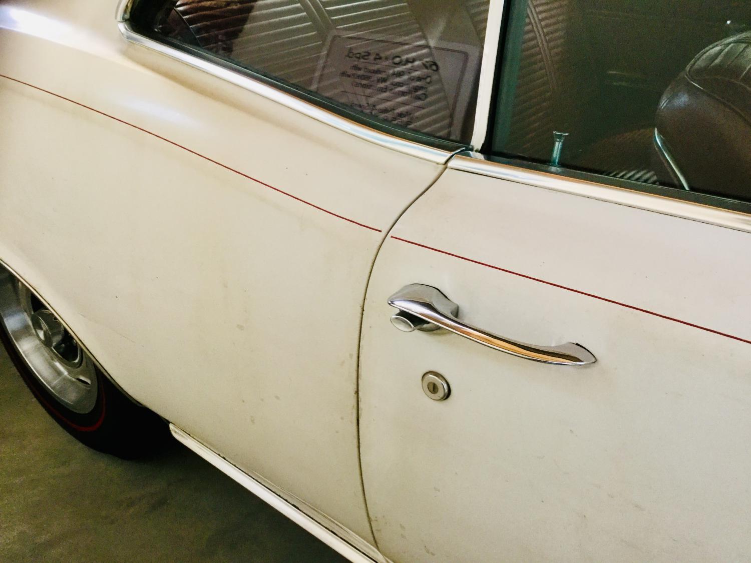

Default Another Survivor paint car.
This ‘66 GTO was built at the Fremont plant (01B).
Cameo Ivory with Red stripes.
As I mentioned earlier, the application varied from plant to plant.
Obviously they used a wider tape at the seams which allowed for a wider gap in the stripe.
Notice the “ribbed paint wheel marks” and the paint bleed out at the tape in the last photo.
I doubt you see this on a high end restoration.
Survivors are the best, an encyclopedia.

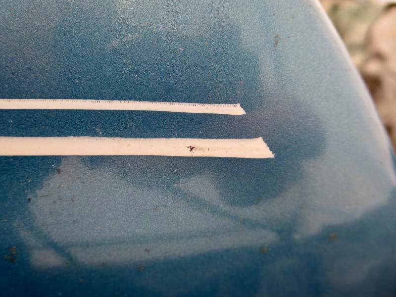

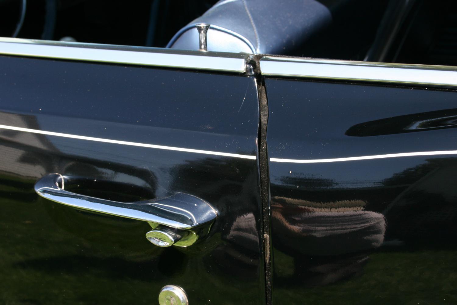

Default 1967 Factory dual pinstripes
Here are a couple ‘67 GTO’s with their factory stripes.
You can really see where that tape was allowing the paint to bleed out.
Also the Beugler wheel marks in the last photo, top stripe.
Factory stuff.
