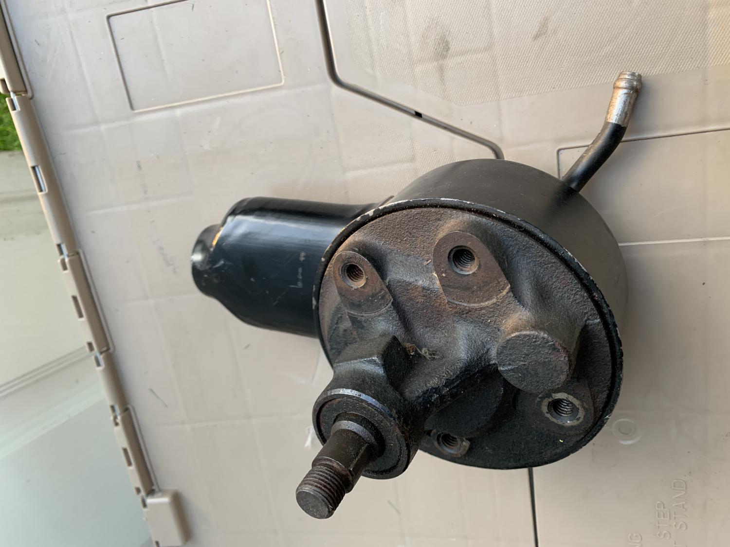

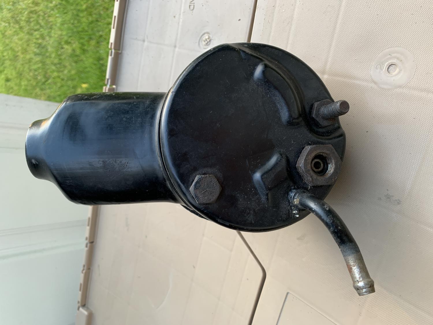

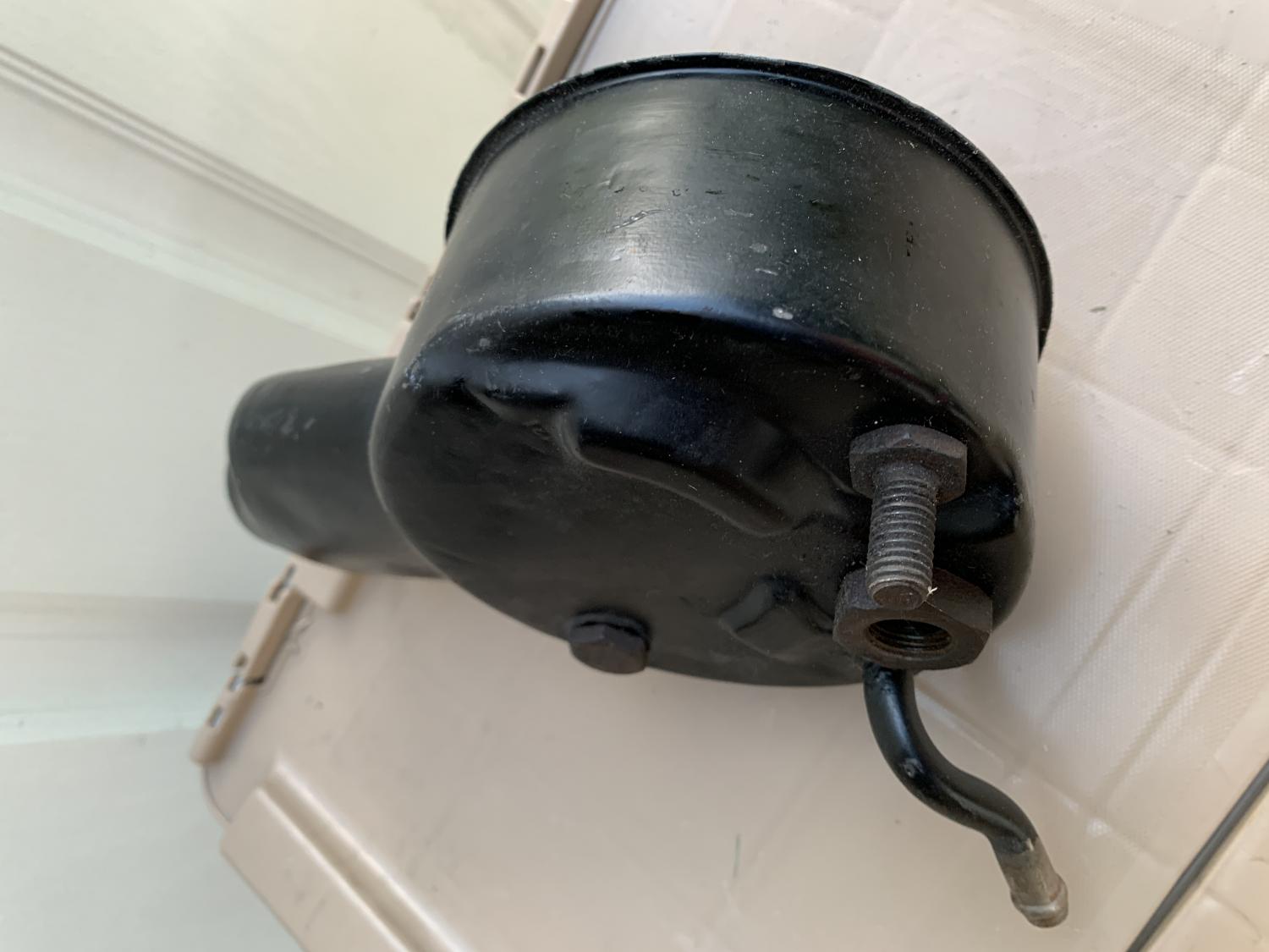

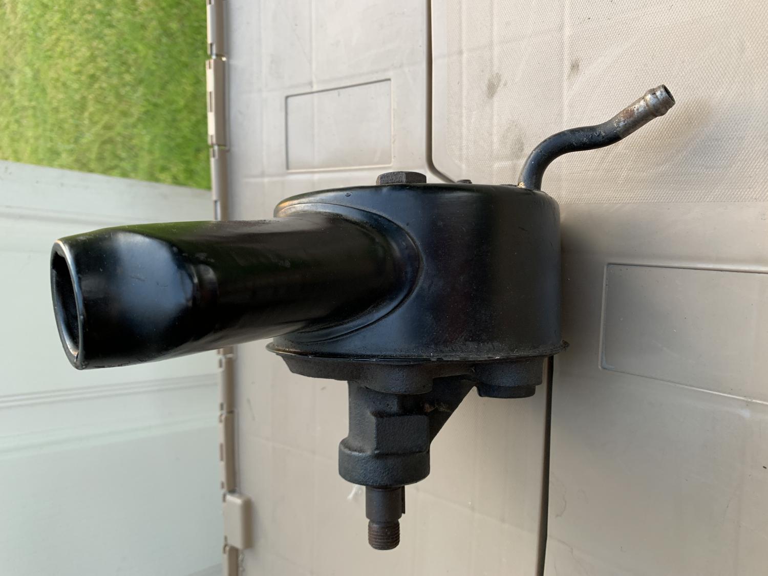

Need help to identify this p/s pump, I was told it is not a 69 Camaro BB.

1969 BB pumps have the return line coming out from the bottom of the can. The pump you have pictured was used on 1970 and newer Impalas and 1973 and newer trucks. Nova, Camaro, Chevelle pumps had the return line curved back toward the engine. Hope this helps.
