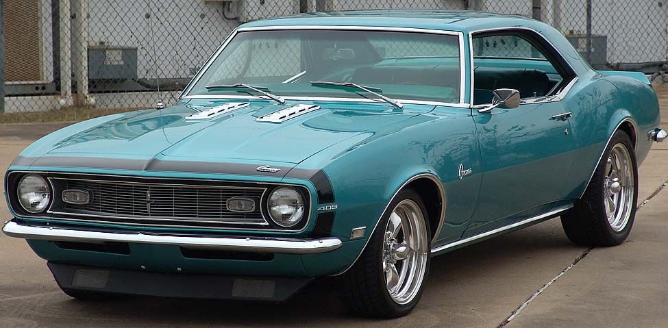

Looing for a code for Bc CC for 1968 Tripoli Turquoise
I see what appears to be multiple hues of the same color and was wondering which one was more correct to OEM ?
Below are some picture's I found, with a link specific to the 68 L79 Nova of Rick Thayer in particular is the color I'm after.
The Camaro pictured below look different than the Nova inthe link ??

I would say the Nova is more correct in color. Could be the lighting and angle of the pics that look different between the two.

You could put the same car picture up on three computers with the monitors side by side by side, and swear they were all different colors.
You really just need some paint samples in hand to compare.

you can not judge a colour by a pic . lights.... sun make a huge difference in what it looks like. if you have a panel with the colour you want some paint stores can colour match it with a scanner .

Also cars built at different times of the year might not be the same as yours. Remember GM was selling cars & not show cars, Try to match what still remains that is known original...Joe
