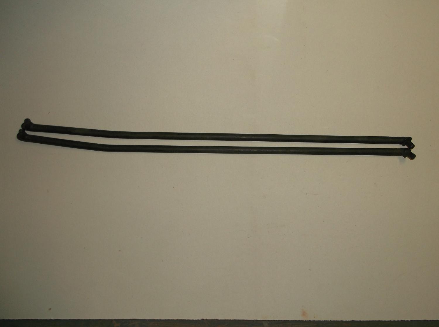

Default 69 Camaro 4-speed Back Drive Rod 5773 Versus 5776
Just trying to confirm which lower back drive rod for the 69 Camaro 4-speed is a little longer, the SB 5773 or the BB 5776?
CRG has pics of the BB shift rods versus SB shift rods but no info on lower back drive rods.

Here are some pictures of NOS 3955773 and 3955776 back drive rods with the part numbers stamped into them.
The 3955773 is longer by about 5/16". A tape hooked end to end measures 20 11/16". Center to center on holes is about 20 5/16".
The 3955776 is shorter by about 5/16". A tape hooked end to end measures 20 3/8". Center to center holes is about 20".
- Warren

Thanks Warren for the pics, when John adds his pics to also verify, I am glad we can end this discussion with everyone on the same page. These rods over the years also get altered or bent and add to the mix.

Great photos Warren ! We are on the same page . Will post photos.
