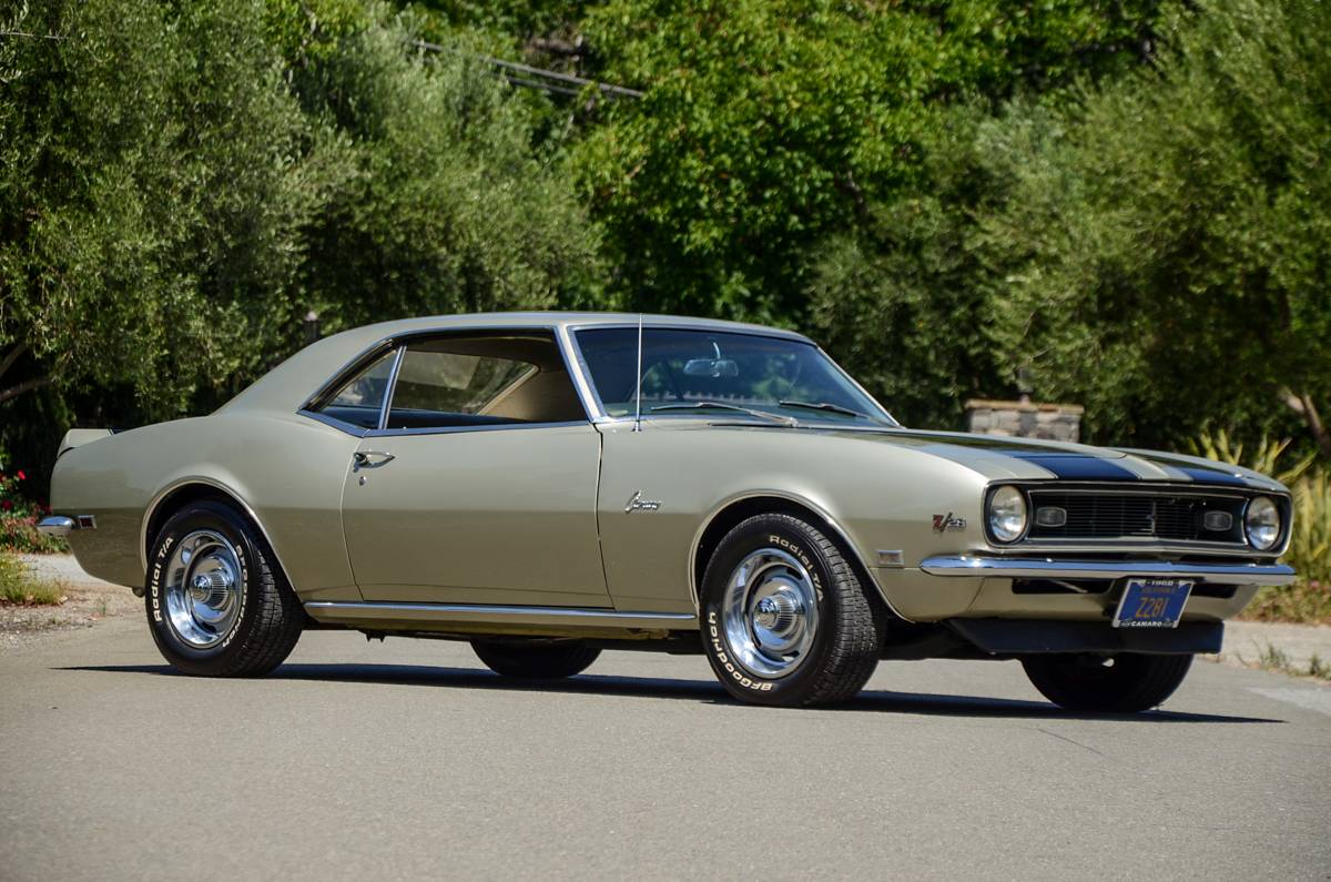

I like the colors

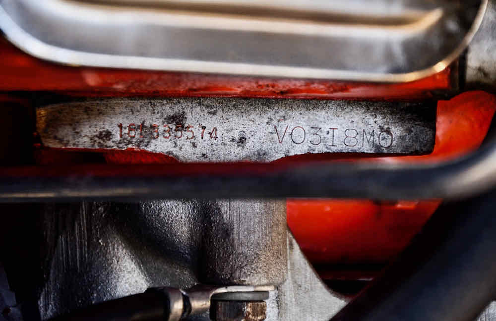

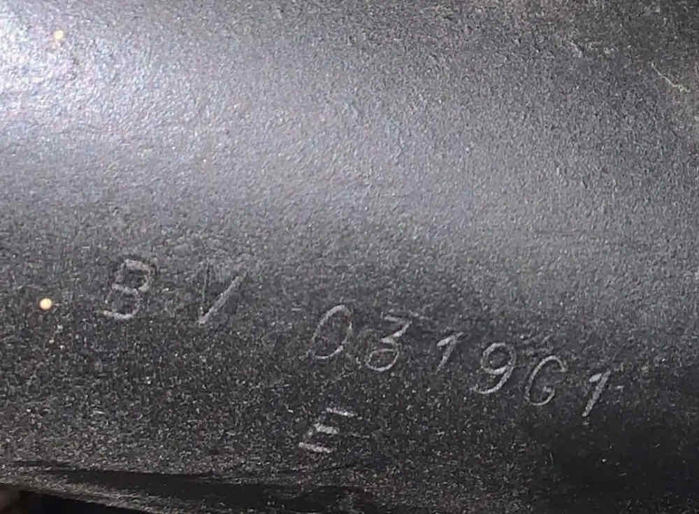

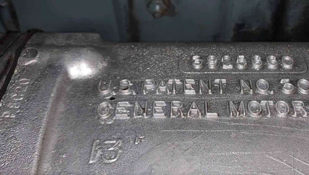

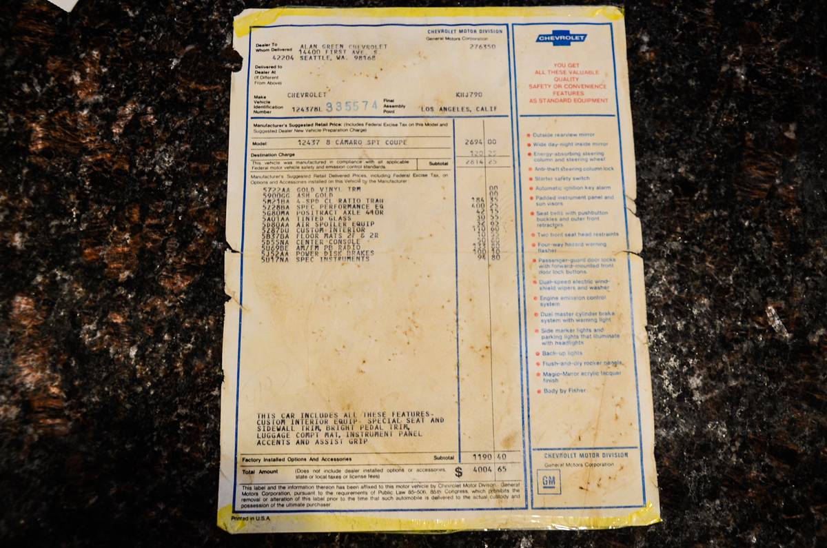

Not sure I like the font and spacing here ("DISK" brakes??) but maybe William or Kurt can chime in.

Homemade & then aged window sticker.

Rallys look like 14"?

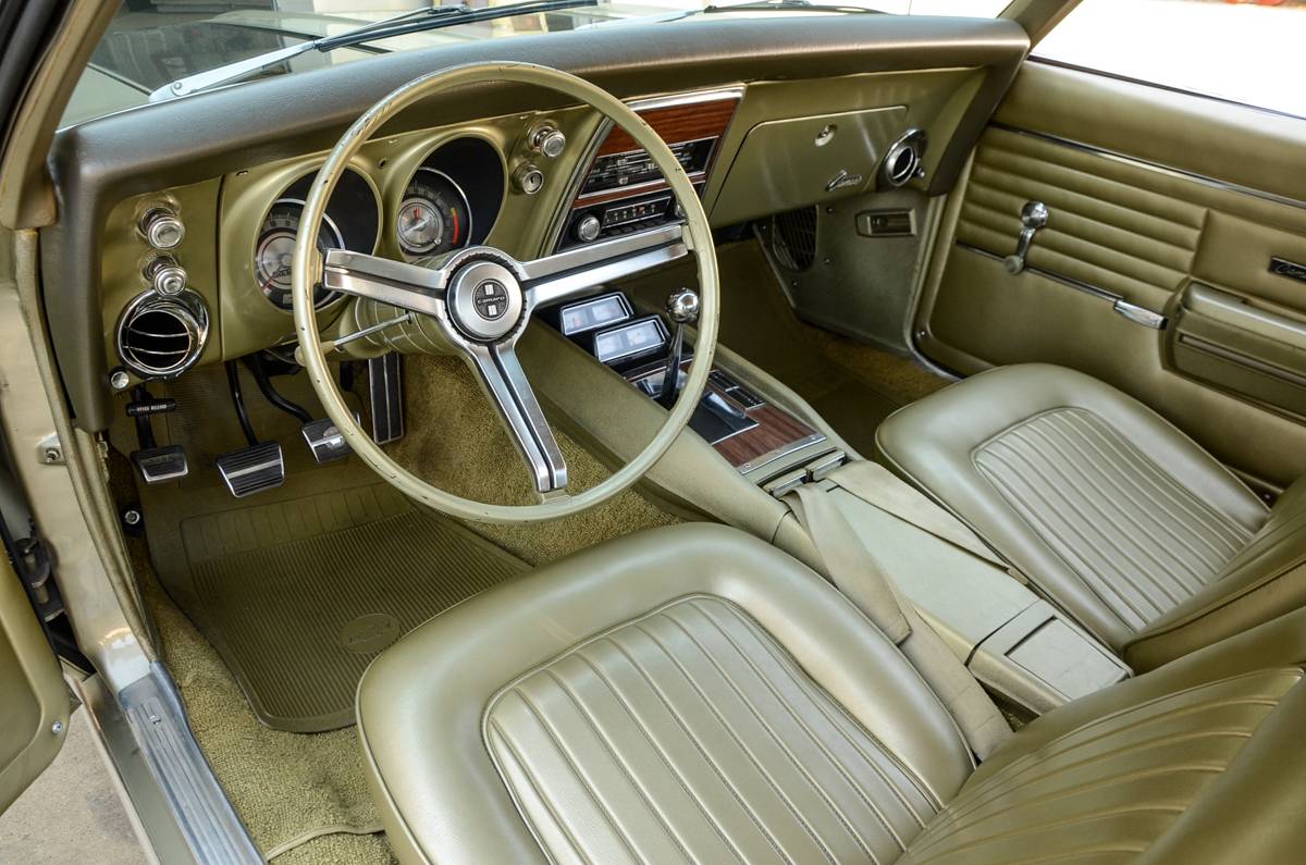

Z87 Custom interior is the DELUXE INTERIOR package - wood grain - molded door panels, the emblem in the seats, the steering wheel with the shroud and the horn buttons color keyed.

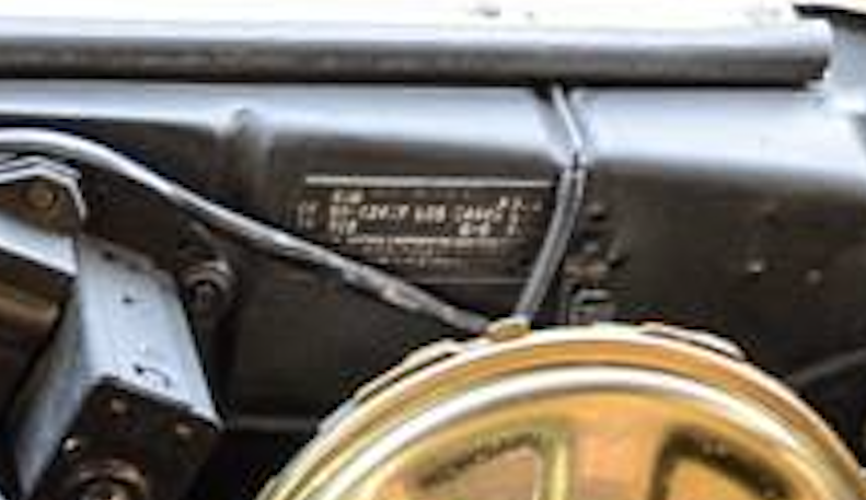

Does the cowl tag have a 722 indicating Gold Deluxe or 721 indicating gold std?

Good question, but no pic of the TT provided.

Could be a 2 at the end of the trim number...tough to make out, but not much like a 1

James, I'm pretty sure 722 is standard gold for 68.

Lots of things wrong.....
