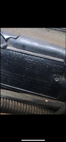

Old 12-20-2020, 02:35 PM
Danzo Danzo is offline
Join Date: Aug 2016
Location: Massachusetts
Posts: 477
Thanks: 9
Thanked 136 Times in 77 Posts
Here you go.
The Following User Says Thank You to Danzo For This Useful Post:
scuncio (12-20-2020)
Old 12-20-2020, 02:56 PM
Steve Shauger's Avatar
Administrator
Location: Long Island, NY
Posts: 5,687
Thanks: 2,758
Thanked 9,429 Times in 1,874 Posts
Not great pics of TT and engine stamp but like what I see... Thanks for posting
www.vintagecertification.com
