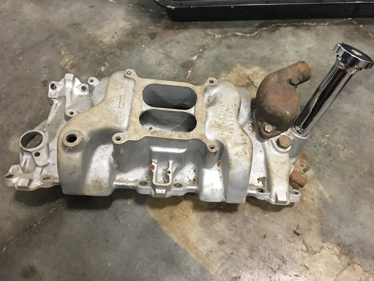

Hey guys, I am making great progress correcting incorrect items on my real 4K '67 L78 Camaro. Ordered correct valve covers from Crane, correct carb, clamps, etc.
Question is, what is the best way to clean the intake manifold without removing it from the engine? I don't want to remove it as there are no leaks and it isn't that bad, just wondering if an SOS pad or some other technique would help me clean it while still on engine???
This is a "before" picture. Thanks!

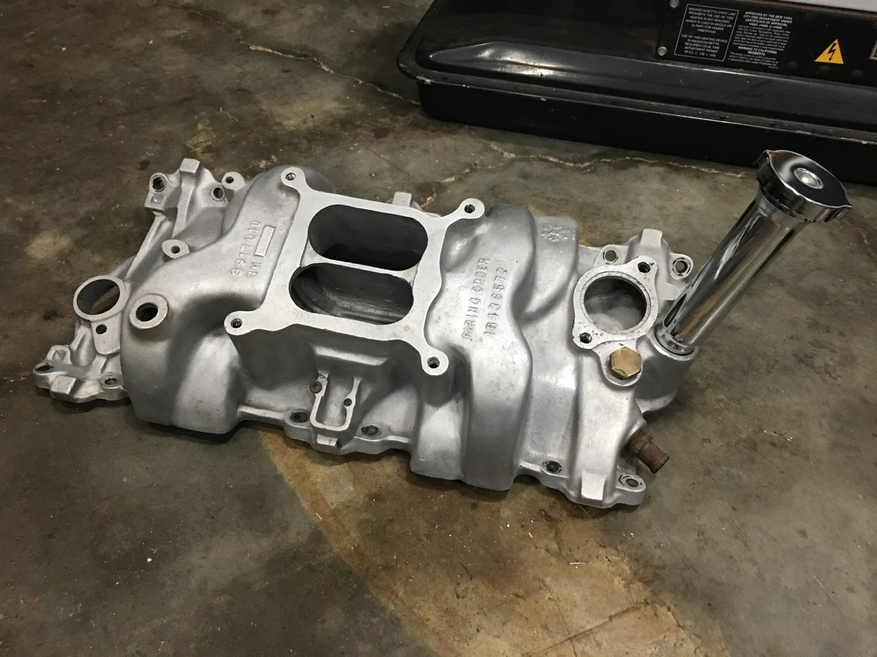

Oven cleaner is one of the best things for removing oils and cooked on greases from iron or aluminum...
To get into the pores of the aluminum use a round stiff bristled brush and wrap tape around the bristles so that they stick out about 1" that way they don't jump all around and you can work it around and get into the pores.
Here is the intake before and after on my survivor LT1.
