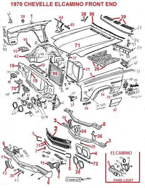

Old 11-20-2020, 03:08 PM
Posts: 21,071
Thanked 3,906 Times in 1,541 Posts
If you pick up a 12" thick Vintage Parts Counter book,they show you an exploded view of many areas of the car section you're interested in.These Exploded diagrams are in the front of each section.
They have an arrow pointing to each part & list a group # down below.
You go to that group section,and all the numbers that apply there are usually shown.
