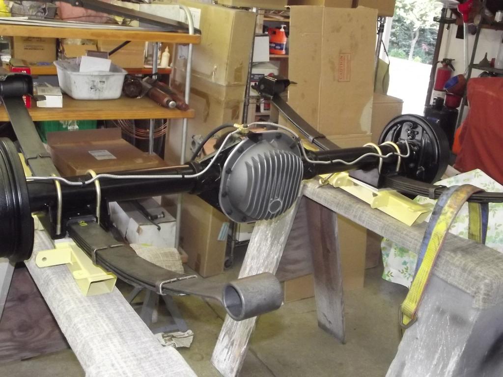

Wow, everything is so clean and new.
Did you put the front mount clips and bolts on just to keep track of them ?
