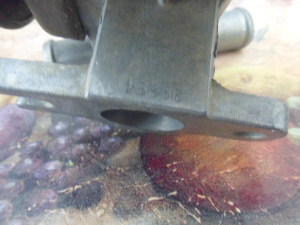

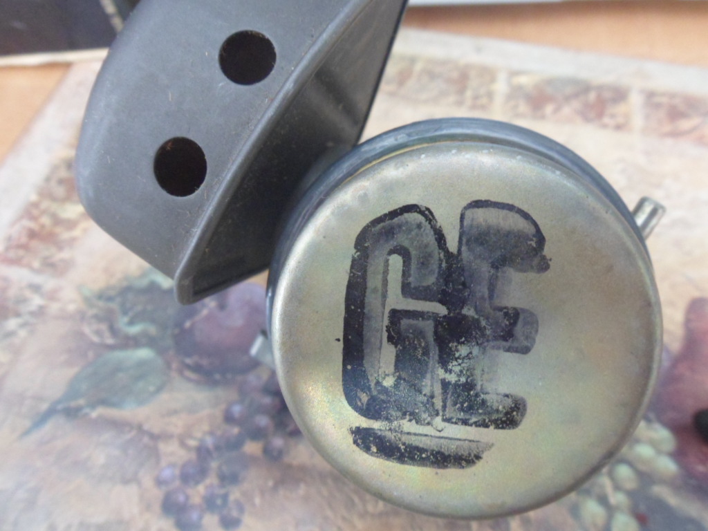

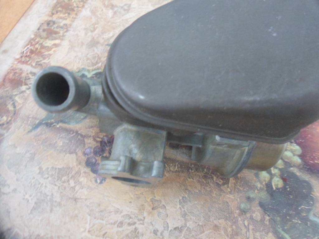

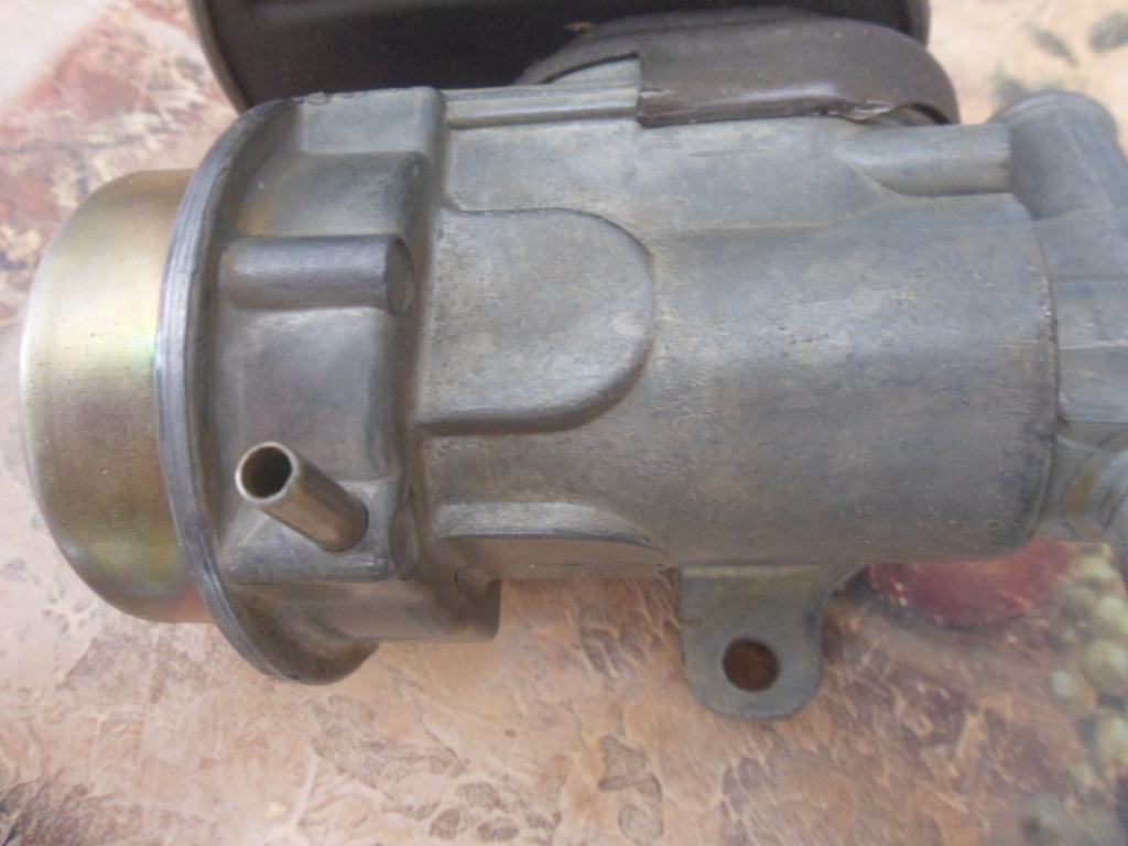

hi can any one tell me what this fits. THANKS

1969 all Chevrolet 6 cylinder

The part and the box don't match. 7029291 is for L6 (http://www.camaros.org/emissions.shtml#valves), but that part is stamped 29294.
7029294 is for 69 trucks with a 307.
