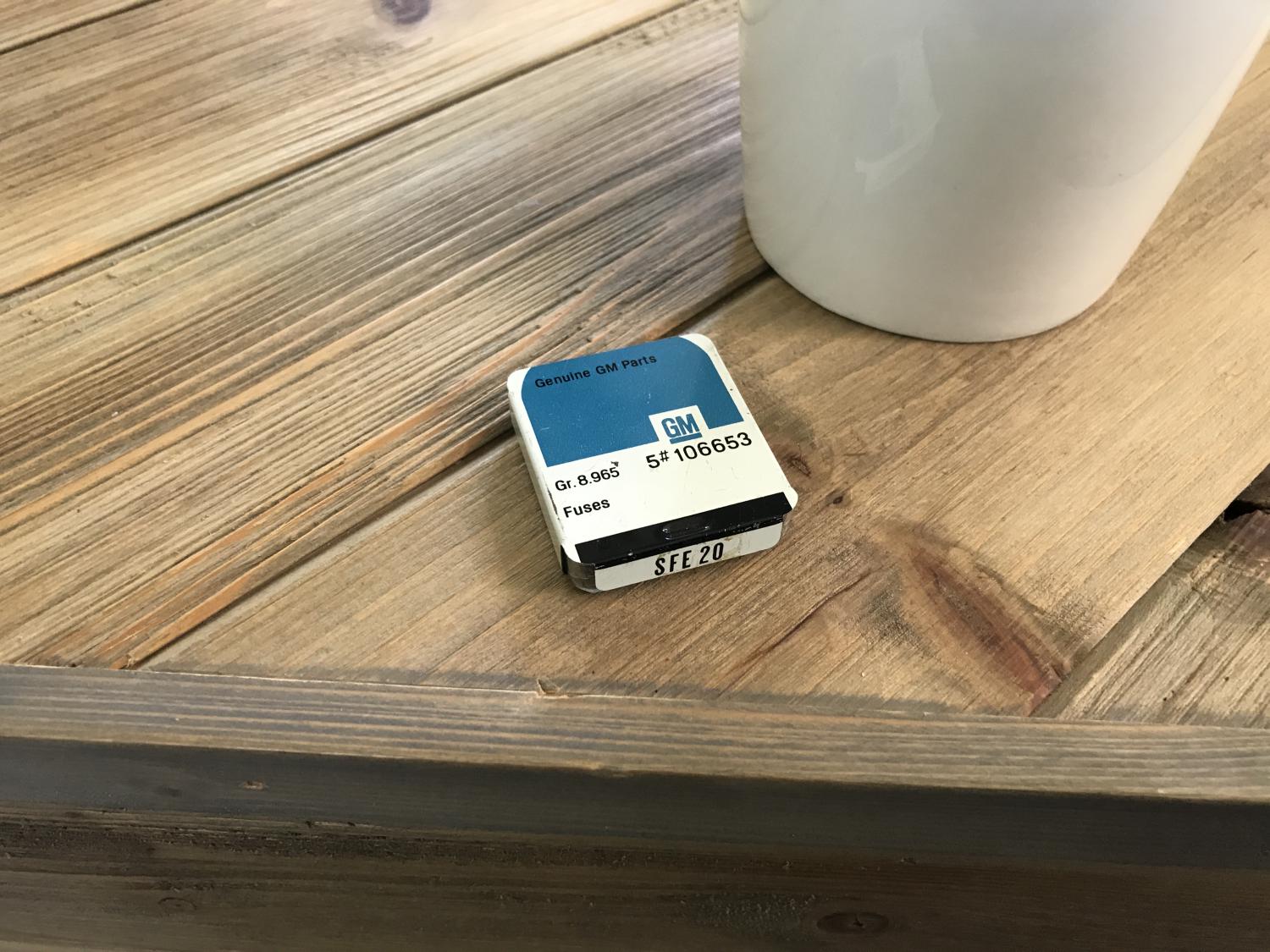

I got a box of 20’s
It's only Orig once
waste all the rest.

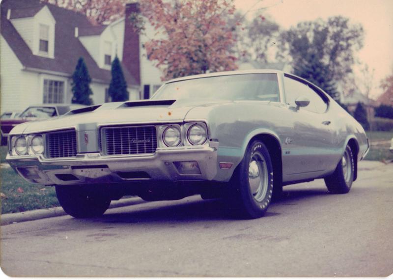

Wthirty1 -
I saw your car list... and with 29 posts I figured there had to be a picture of the rarest color combo, which I have never seen on an olds...
W31 Platinum with Blue Buckets and Blue stripes...
We can't let you out of here without a couple of pictures of that BEAUTY!!!
I love silver over blue or Black over Blue!

Originally Posted by firstgenaddict View Post
Wthirty1 -
These are vintage pictures from the '70's but they're the best to really show the true shade of the blue. I haven't seen another platinum / blue stripe W-car but I'm sure there's another one out there.
