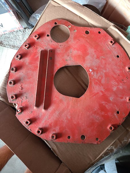

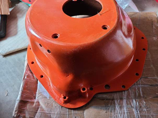

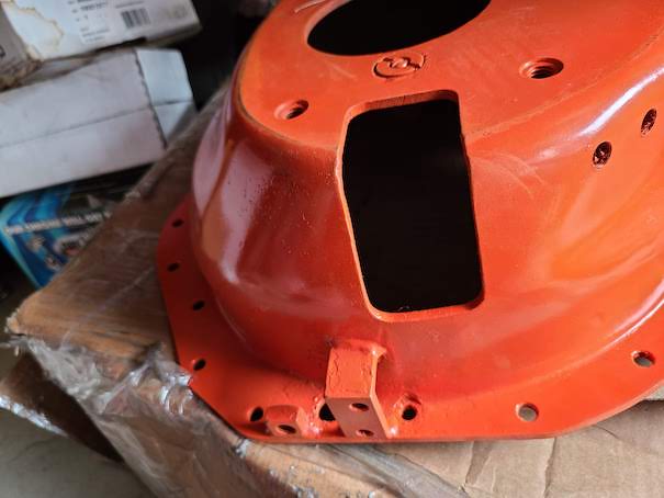

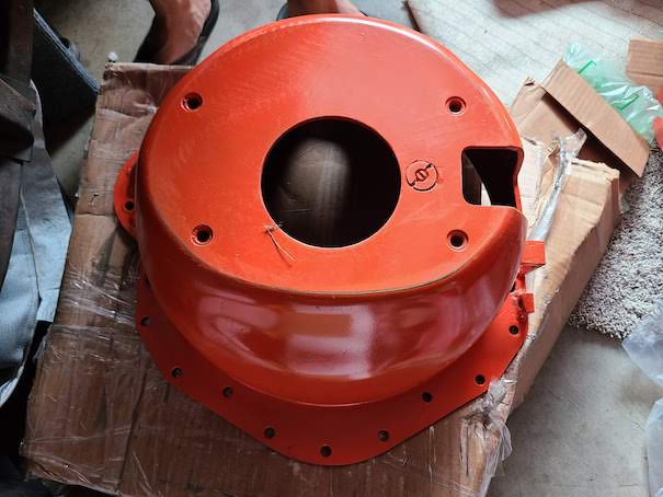

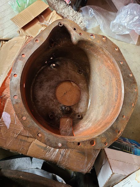

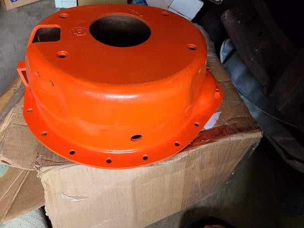

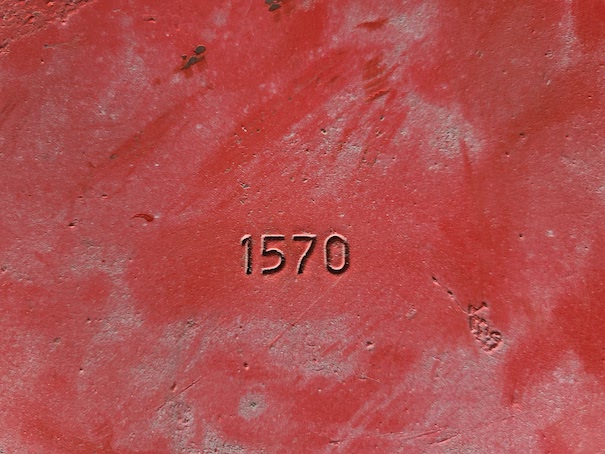

Please help me identify what I have here and what year(s) these were produced.
I have a block plate with 1570 part number and a bellhousing that I don't want to drill to line the holes up with the block plate. I could not find a part number on the bellhousing but it was clearly painted so I can start scraping away with your guidance.
I'm considering keeping the blockplate and finding the correct bellhousing. Do any of you know the matching part number I would need?

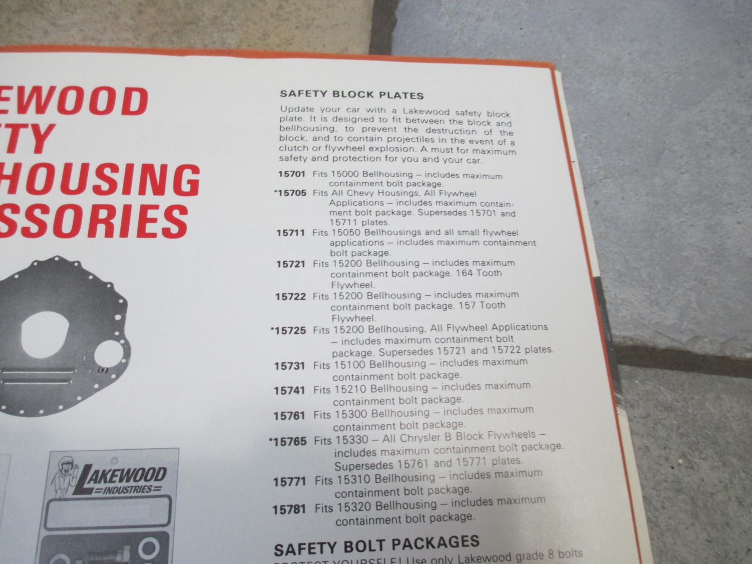

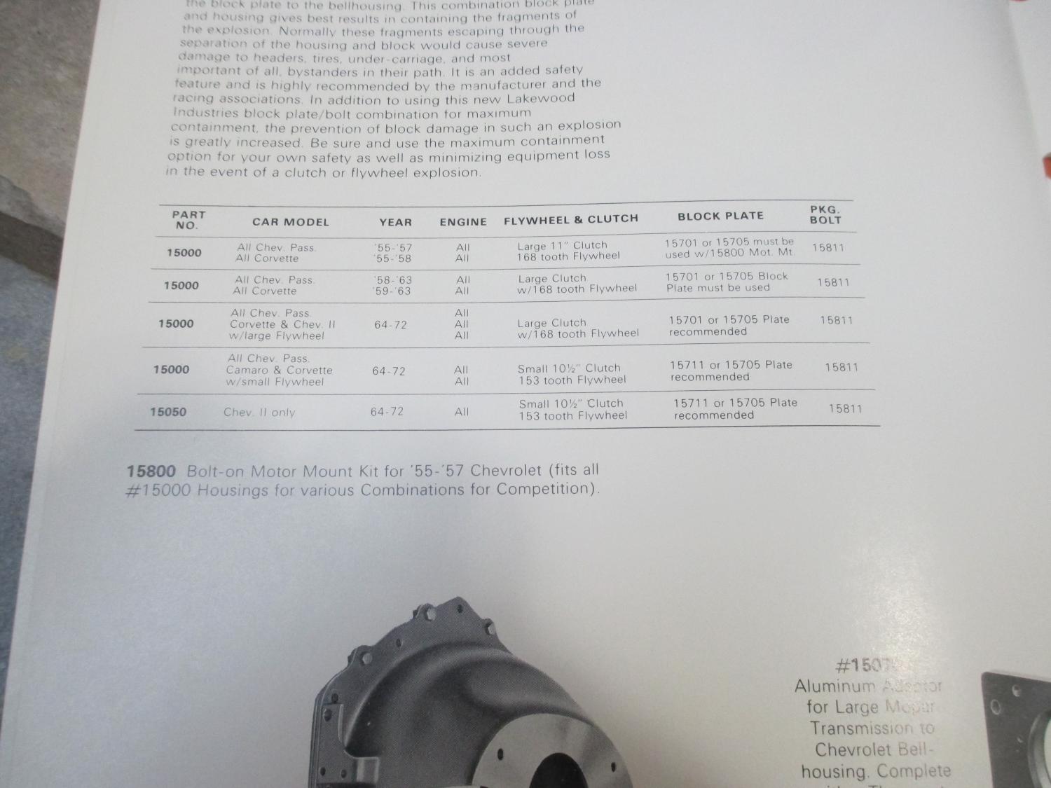

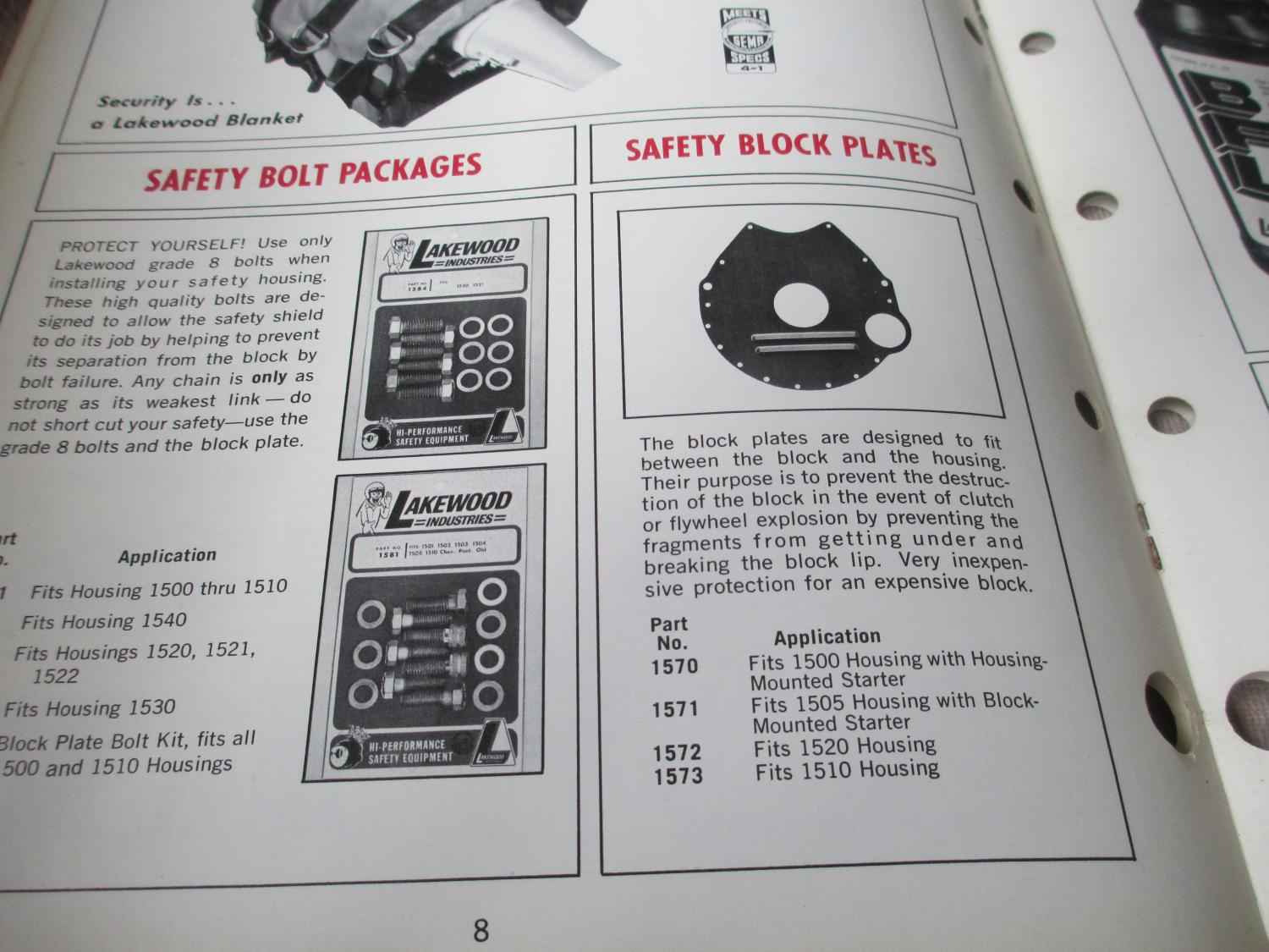

I can't find anything in the 1978 Lakewood catalog on either part. Thanks

Does the block plate fit the bell housing now? Find what you have in the bell housing first to
see if the block plate is good for you.
The block plate seems to be the same as the 1500.

The date on that catalogue is a big help in nailing this down. The scattershield is a newer style, cause there were at least two others before the one with the numerous bolts and nuts that retained the block plate.

Yes it fits but the bellhousing has half as many holes as the block plate on the bottom.
Thank you all for the help. My bellhousing looks like it also has provisions for tri5 motor mounts. I just want a matching setup for my car. Where are the part numbers located on the scatter shield?
