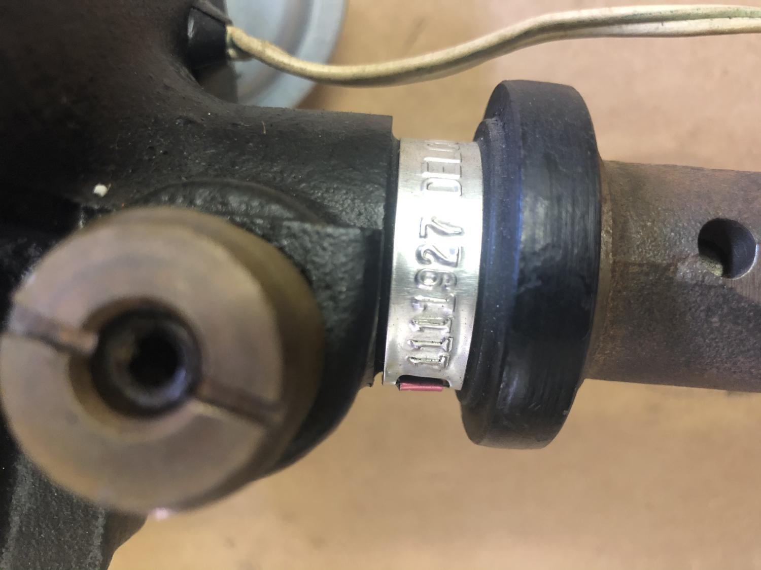

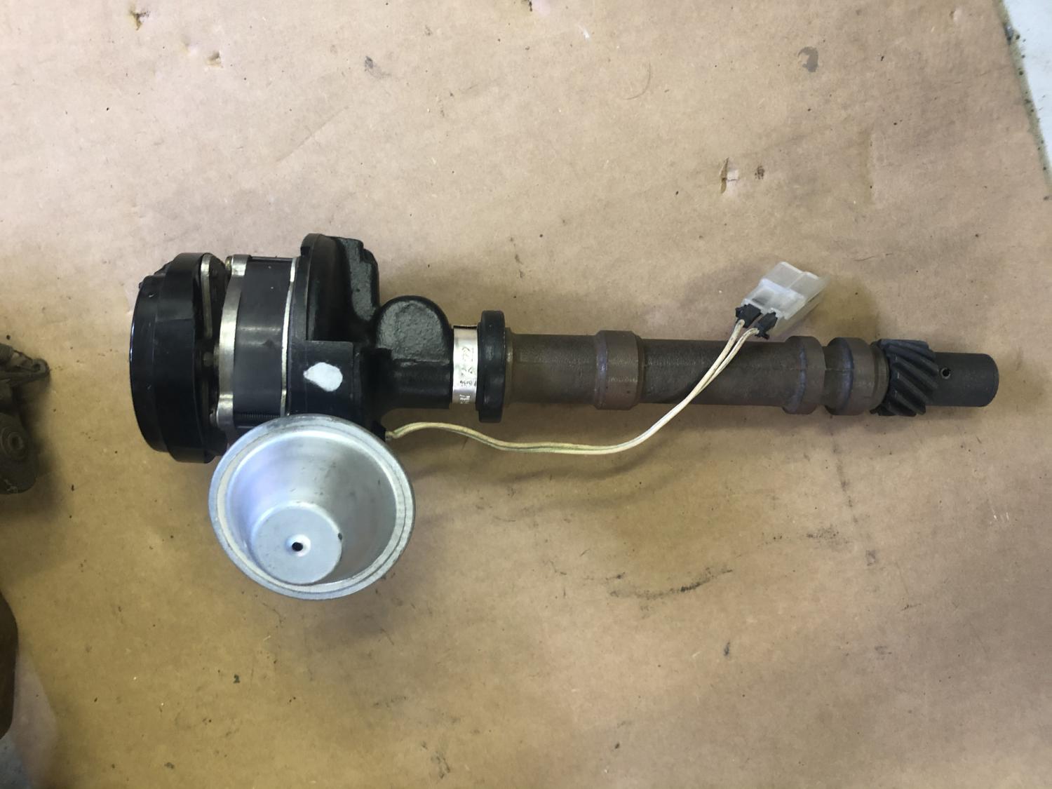

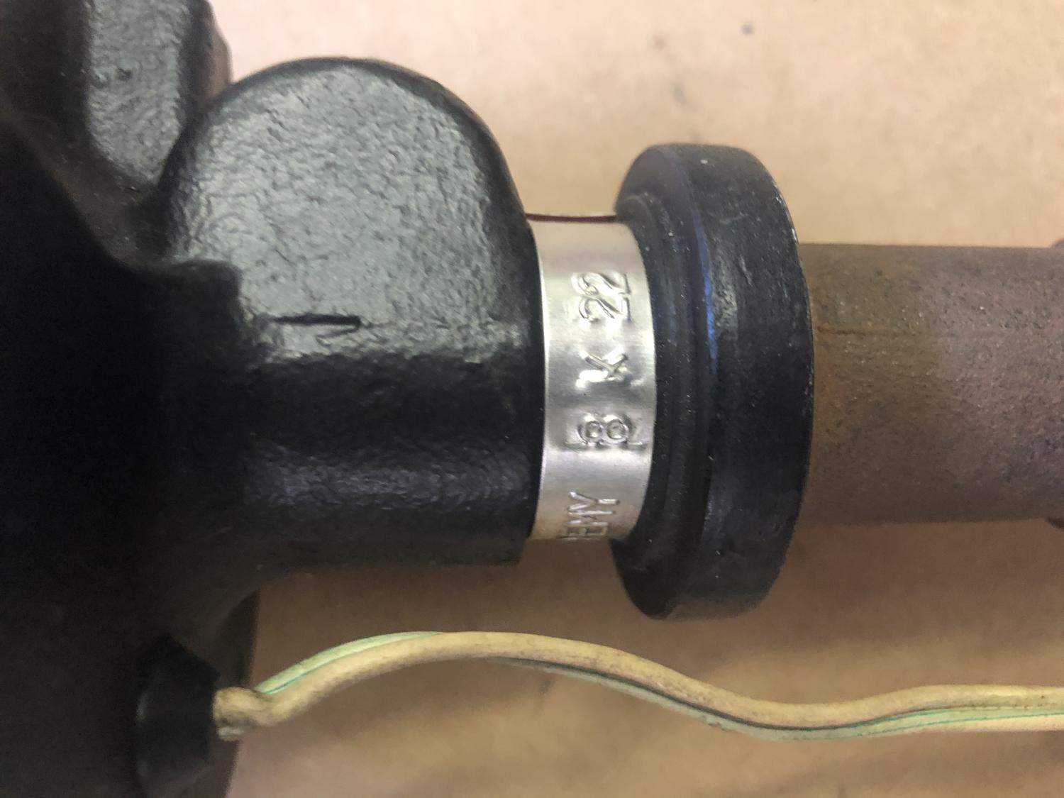

I bought this as an NOS distributor well over 20 years ago. Would like to know your opinions please. Thanks

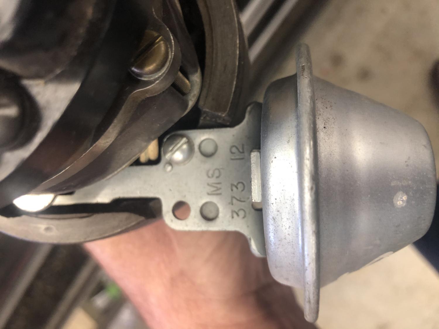

Another pic

Not really a 'ZL1' distributor; K66 was a Corvette RPO. 5,702 1969 Corvettes built with it. Standard equipment on ZL1s.
The production embossed 210 coil is the hard part on K66. Not serviced.

I’m thinking what William is saying is it a Corvette and ZL1 application.
I Think Nov.22,1968 might be a little early for a ZL1 But not sure
as these were built in a batch order and used up and a new batch made
when they needed.
Very meet find even 20 years ago.
Just my .02 cents
Joe

1111927 dist is listed for L88 w/transistor ignition, for what that's worth.

ID band repros have been around for decades.

Looks like a tach drive unit - Corvette only ..... ?

November is not to early. They made a lot more L88 vette than the 2 ZL1 vette, which means more potential buyers. The vacuum advance is very sought after

1111927 also used on ZL1 Camaros. First two were final-assembled Dec 30, 1968 with engines built at Flint Nov 22. Production resumed early March, 1969.

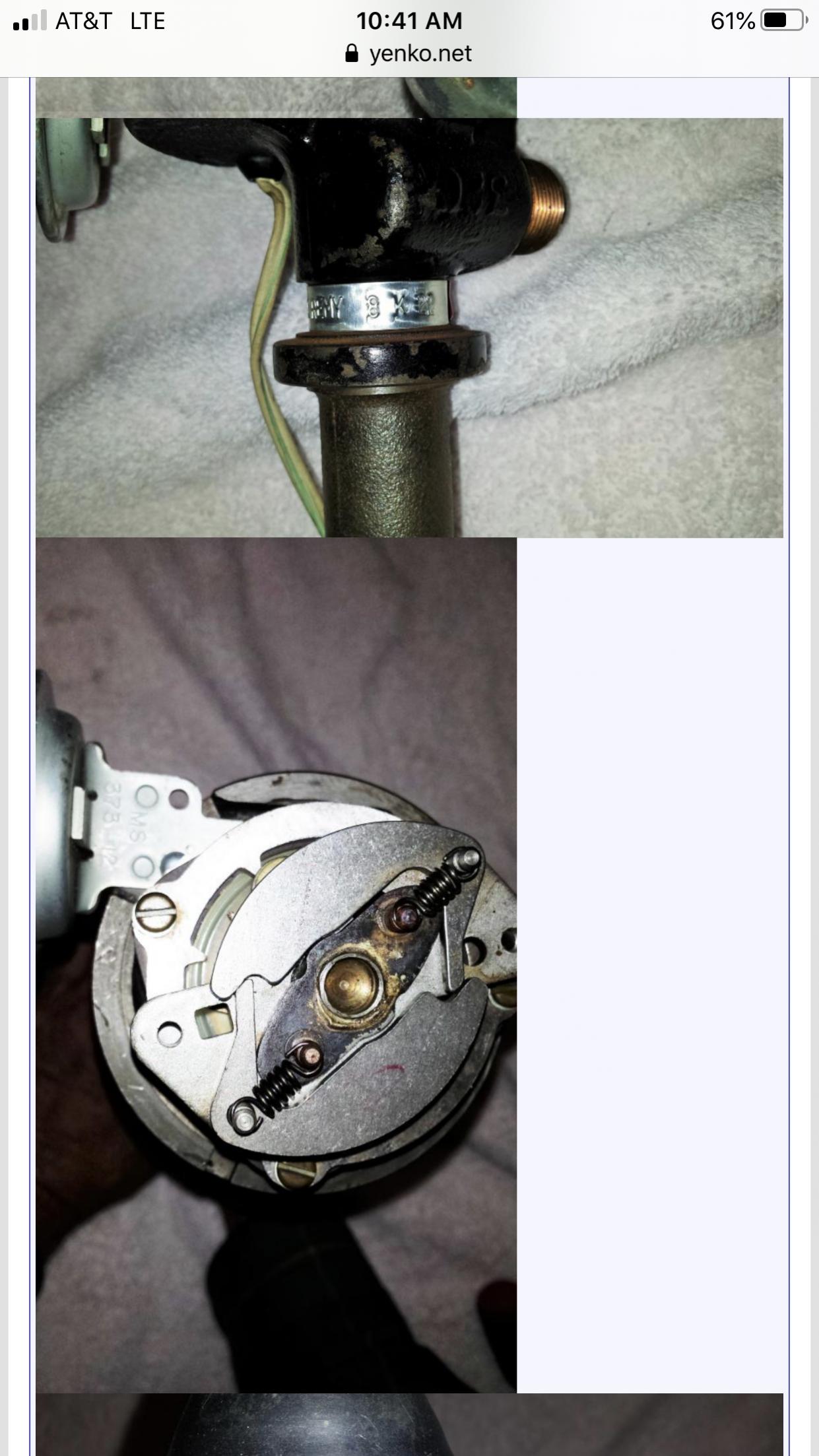

Thanks folks, Anyone have any known dates or known real ones that I can compare the tag to?
