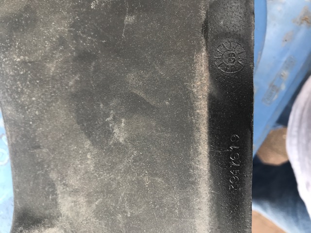

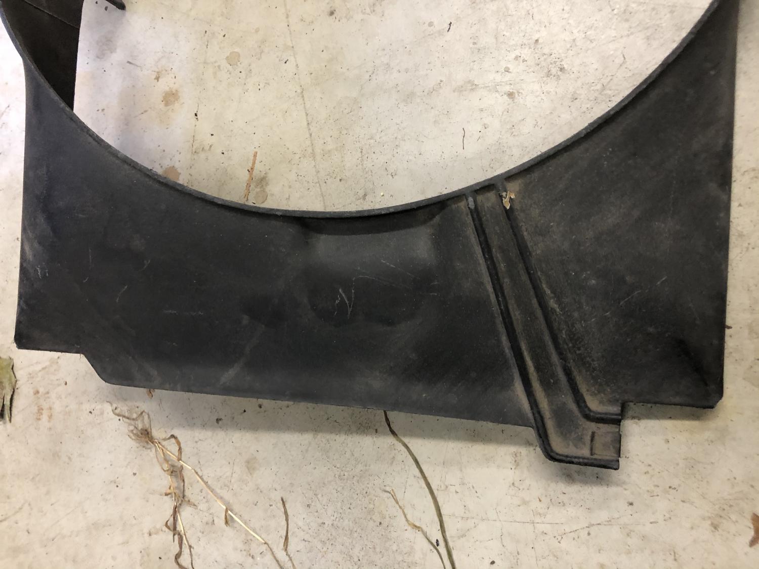

Just picked up some parts from a ‘ junk collector’. How do you tell an original 69 BB fan shroud from a repo? Thanks

Was hoping for some advice where to look so I could post some detailed pics. Looks like maybe it had a spray bomb used along the top?
But here is a few

I am assuming repo.. until proven otherwise.. It had 1/4” of dust and I just wiped it off without cleaning

GM part #??

It's likely the GMPD service replacement. Originals did not have the 3 horizontal beads at the center.

I have an NOS one With tag and an assembly line unit. The only difference I see is what William pointed out - the 3 casting ribs are on the NOS one but not on the assembly line one

^ agree, that's been my experience too; those three casting lines / ribs.

What is it dated?
Dated next to pt. # in the middle of the circle
Three “worms” on top were later over the counter parts
Joe

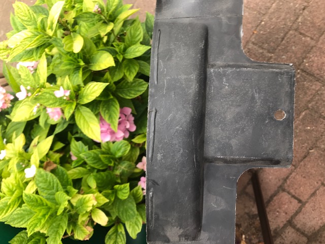

Look on the passenger side, inside outer wall of the shroud. Mine has the part # and a round clock emblem. See pics. looks like its dated 12 68??? or 12 88
