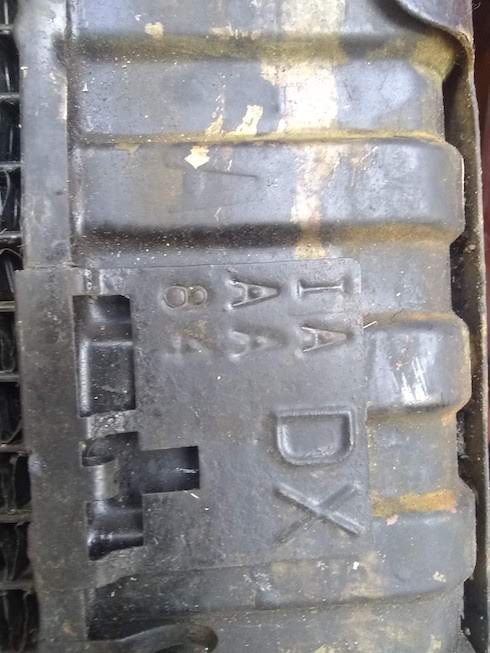

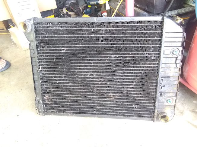

Core measured 21" wide. Hopefully you all can help me decode this I have no idea.
Thanks!

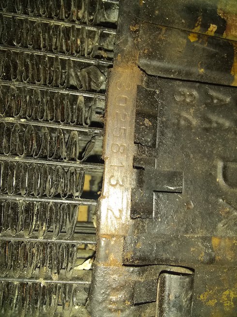

I have a guess, but first what is the number on the bottom edge of the tag? 3025813?

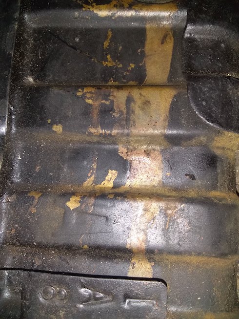

Yes. "3025813 2" I also noticed AA on that tank. Pics attached. Thanks!

Thanks for confirming the number. I wasn't sure on it. I can't find anything on the number, but it's a mid-70's Chevy. Pretty sure Nova.
It could be from a '72 Nova 250,307,350. That part number does check out. Hmm... I'm going to let this radiator go but want to advertise it correctly.

L1 in the depression between the AA is the date code - December 1971.
Wow good eye. Didn't even notice that and learned something new. Thanks
