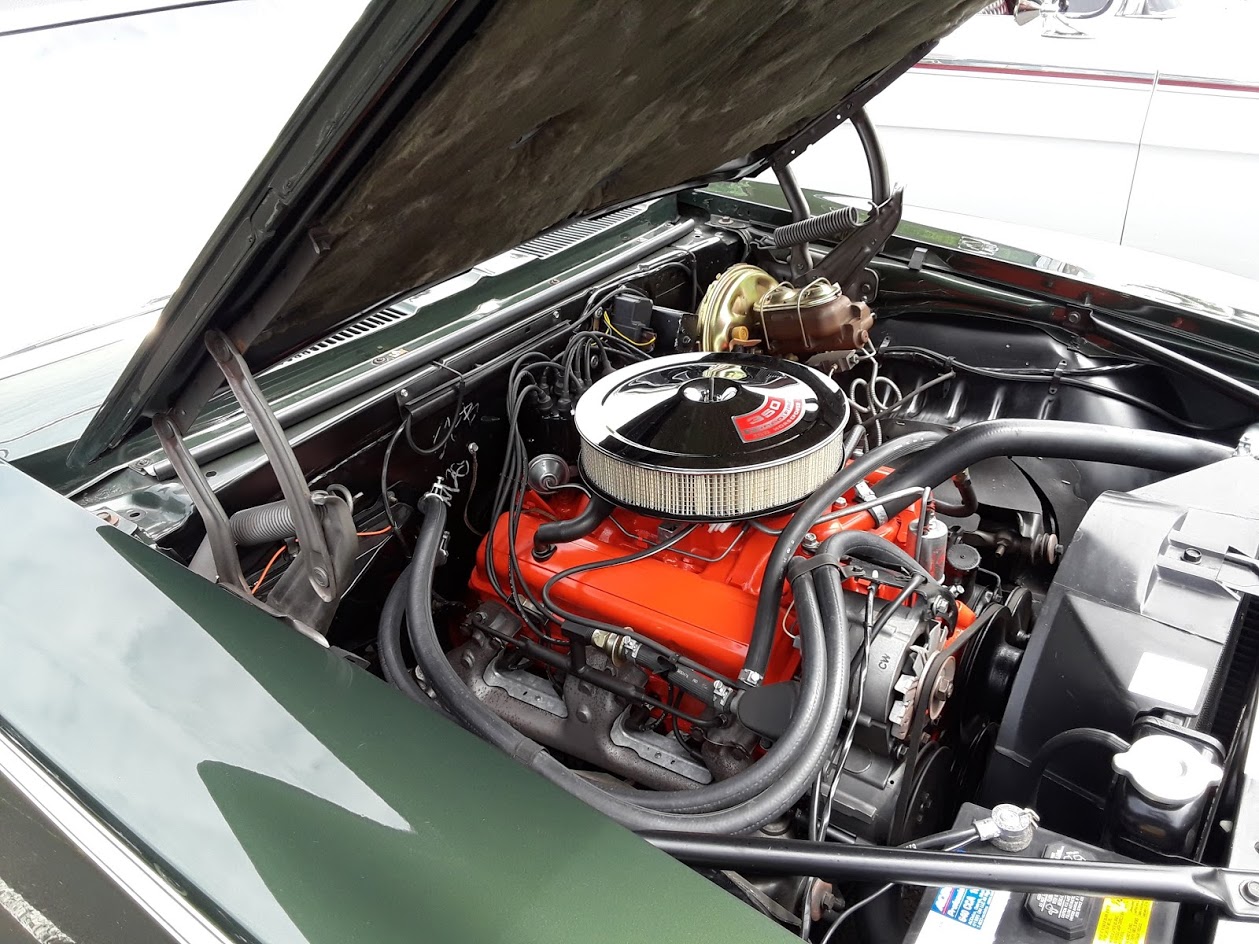

I have a '69 SS350. Maybe these pics of my engine compartment may help you.
I currently own a 1969 Camaro SS350. Although the original drivetrain is long gone, this 4/speed car has a March '69 HC coded block with #041 heads. The transmission is an M20 Muncie #660 case and the rearend is a BS coded 12 bolt posi. Built in Van Nuys.

A very nice example
