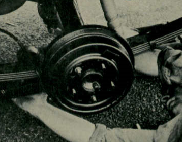

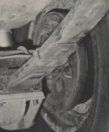

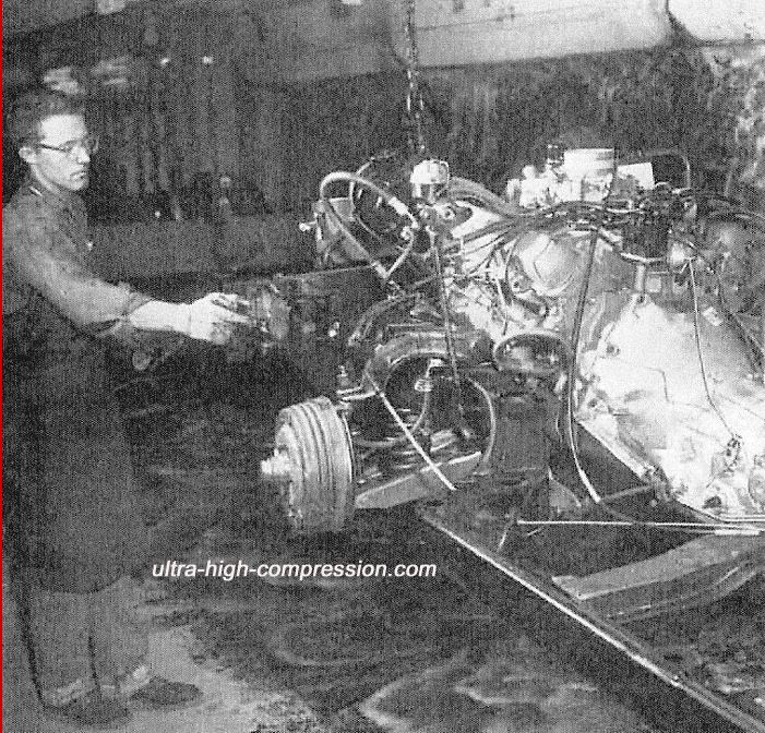

Pretty certain this car was owned by a guy who lived a couple blocks from my parents in Wauwatosa, WI. Looks quite nice to say the least, but I'm surprised it's still original paint with all the obvious (extensive) restoration on the engine bay and underside.

The axle tubes are leaking or have been welded , someone went crazy with the Ultra Black silicone..
