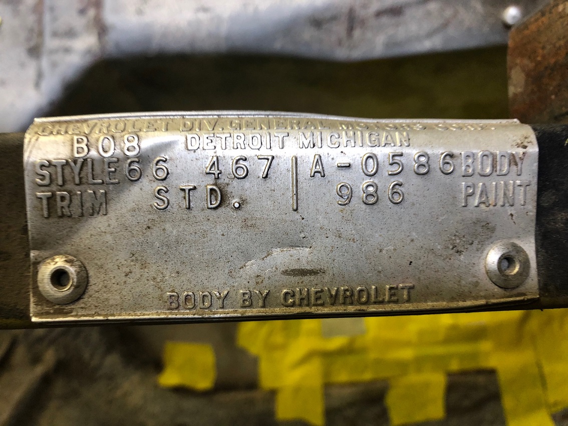

I like to decode TT's, and a friend has a '66 Vette, body is in primer on a body roller, and I helped him move it yesterday. I haven't seen the frame or engine/trans/rear. I helped decode the TT and VIN, but noticed the large gap between the body build date of (presumably) Sept of '65, and the car build date of approx June of '66. Is this normal, or did I interpret the codes wrong??

Ruh-roh. Something doesn't match and I'd say that VIN has been off the car.

Yeah, didn't the Corvette line use rosette rivets for the VIN tag??

Marlin, unfortunately the Rivets on VIN tag are wrong... should be rosette. The trim tag is too dirty to determine authenticity. Can you please clean it and provide a better photo?

Vin Tag has been off ( as posted) rosette rivits were used 1965 on.
Check the frame hidden vins to see if they match the vin tag, 2 locations on drivers side- on side rail top about drivers seat area and drivers rear rail about level with rear suspension trailing arm rebound bumper. Trim tag looks OK IMO. Body is a roadster correct?

Yes, body is a roadster, with silver paint remaining throughout the interior structure. It had a new nose installed (??), I'm not sure how you do that on those bodies but it looks pretty nice. It's a pretty standard unit, silver/black vinyl with a 327 and 4 speed.

I dont know on other cars but on C2 Corvette
63/64 - spot welded vin tags
65 early - regular rivits
65 later - rosette rivits
66 -up - rosette rivits
