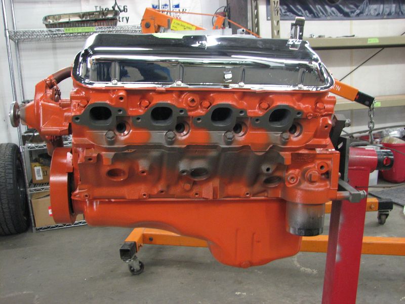

I would imagine that the CKO engines at Tonawanda would have similar markings to this CRV and MQ markings.
I have also seen a purplish pink wide brush mark where the intake meets the block and head on the front driver's side of the block as white paint marks on the sides of the blocks but cannot find a photo of these at this moment. If I do I will post them.
In addition, I always paint my blocks with a cast iron color, install a set of shop exhaust manifolds and then shoot the Chevrolet orange like was done at the Tonawanda plant.

Thanks Rick for posting the picks and sharing. I'm doing my block the same way. Cast blast the block and water pump. Painting the oil pan timing cover in a natural steel paint. Probably put CKO on the rear and call it a day.

the biggest thing I have seen is just don't put too much paint on the engine.
Rick's engine looks perfect -as illustrated by his photo the water pump snout had a card board tube on the end to protect the fan mounting surface from being painted.
If you lightly coat the exhaust manifolds they will burn off nicely and still have the paint left on the manifold ears and bolts.
Here is one I did 8-10 years ago.... I used an airbrush to limit the paint on the manifolds - they were fully painted, they burned off and looked perfect in my opinion.
