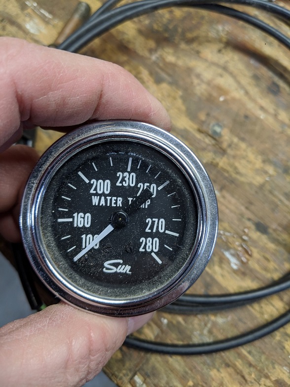

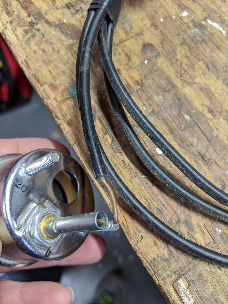

Anyone know if this can be fixed? The lead outside the gauge broke.

Nope...once the Capillary tube is cut or broken...gauge has other uses like the chrome bezel or casing for another gauge. Cheaper to get another gauge then to try to fix this one.

you may be able fix it yourself..let me find the link..ive fixed 3
https://www.ply33.com/Repair/tempgauge

If you can not find another and are partial to the gauge, then I would try Williamson's Instruments, Inc. Talk to Ron or Sandie. I believe they can help you out.
https://williamsons.com/
