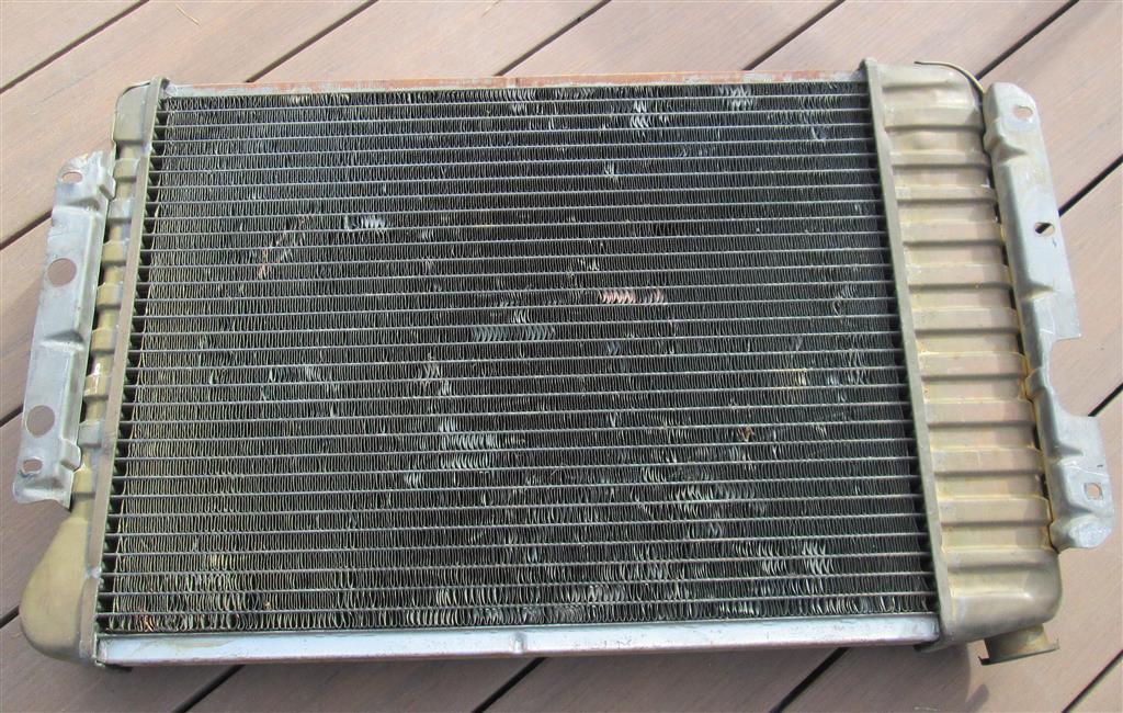

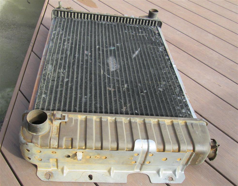

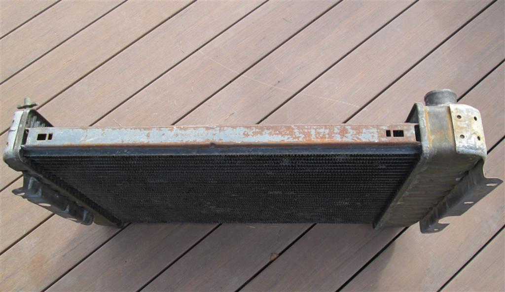

I was wondering if anyone can tell me if this radiator can be IDed as a 1967 or 1968 model or if it is the same for both? This just came out of a storage locker that was sold due to non payment of rent. The locker had a bunch of big block parts in it. There was also a 68 Camaro gauge cluster in there so I imagine the radiator was out of a 68 Big Block car but can't say for sure. I plan to list this radiator in the for sale section but I want to be sure I am listing the correct applications. The CRG site shows these tank codes as 67-68 Big Block Camaro with manual trans. Is this also correct for 67-68 Z/28s?
Thanks,
Jason

I scrolled down a bit more on the CRG site and saw more details on usage. It looks the the Z/28 used a 21 inch wide core and the 396 used a 23 inch core. This one is 23 inch so it looks like it is big block specific. Can anyone tell me if there is any difference between 1967 and 1968 units?
Thanks,
Jason

I think there is no difference between the years

The 67 top channel has holes drilled in it.

Your radiator is a 68.
