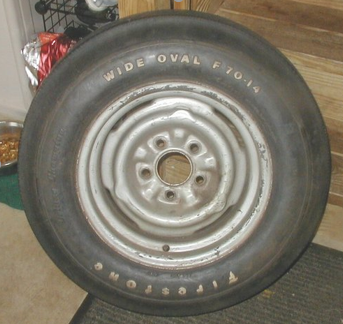

Hi Chris I found some vintage ads for the 1969 Camaro
model year and it appears that one photo does show that
the car is equipped with Firestone RWL Wide Oval F70-14's.
Not sure if it matters but all 3 pics are non high-performance
cars. The convertible has what looks to be a 3/4" or 1" white
stripe with steel wheels and wheel covers. I understand that
you have factory rally rims but in my opinion both these tires
would look good on any wheel (steelie or rally). Good luck.

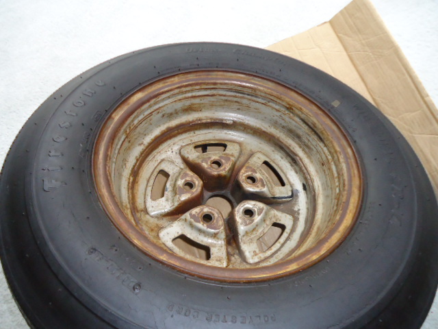

Were any 69 Camaros actually delivered with Firestone Wide Ovals? I have 5 F-70-15 that still have the stickers on them. After I bought them, I thought it was determined that Wide Ovals never came on 69 Camaros, so I never put them on my car.

F70 x 14 yes; F70 x 15 no.
Originals were small RWL; all current repros are incorrect.
