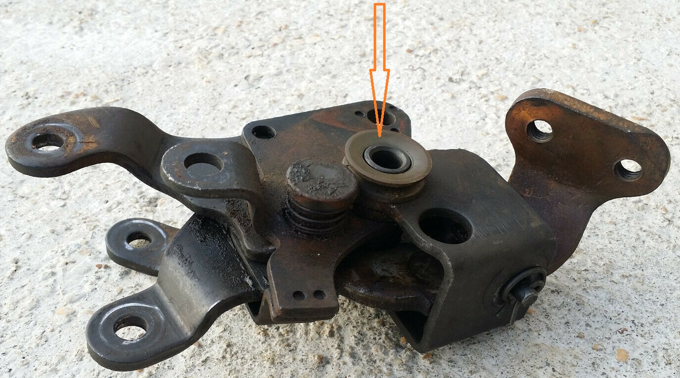

Hi Guys, wanted to know what this MUNCIE Spacer or Bushing is called?
I have a shifter assembly missing this and want to buy it, looked all over eBay but no luck. It is made out of a hard type of plastic.
Any help much appreciated as it is for a member here and I would like to get one for myself too.

it is a rubber donut that goes on the main shaft bushing between the shifter and the mount bracket
originals are hard to find because the rubber gets hard and breaks
I don't know if anyone repops them
Some people make new ones from rubber grommets but its not the best solution

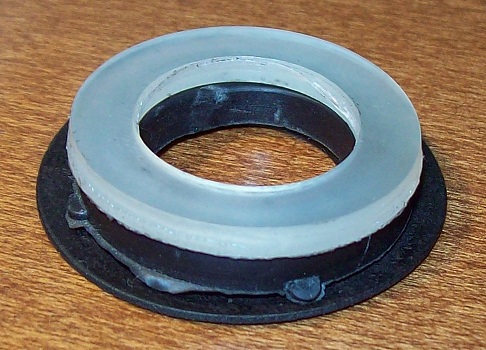

Your right mine used to be a rubber donut that dried to a hard plastic and broke apart in a bunch of pieces.
I made a spacer donut that fits perfectly myself, bottom is a thin rubber washer, middle is a outside hose rubber washer and the top is a plastic nylon Oil Pan washer.
The fit is dead on in thickness and the center hole fit is dead on.
Better then having nothing.
Can't believe no company makes this out there oh well.

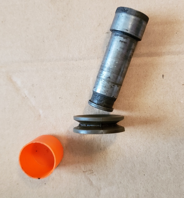

I can get the dimensions but its not just a simple washer shape
it has a groove on the outside diameter
the inside diameter is undercut to lock into the bushing

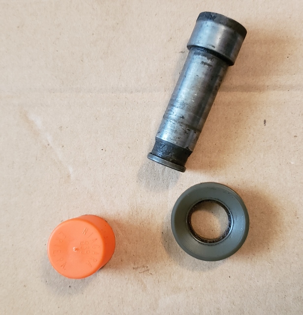

this is what was left of mine after it dried up LOL
the orange dust cap is fine
