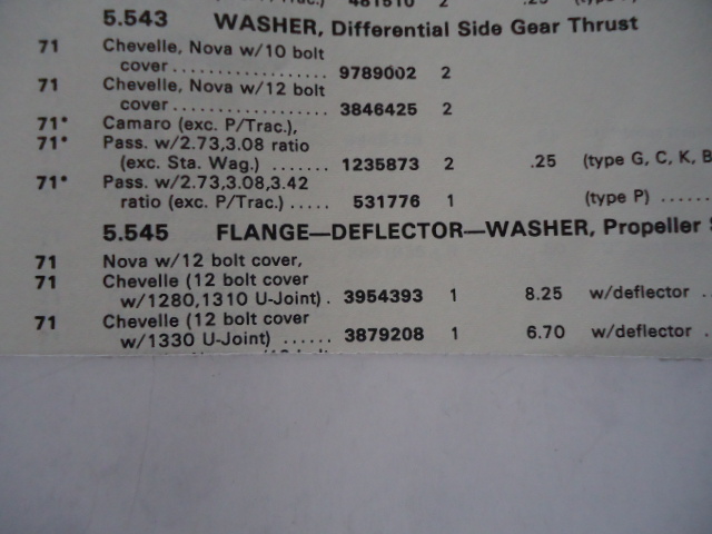

3954393, from the Aug 1971 P & A manual. BE was not different. I'm sure one of the aftermarket drive train suppliers carries it under the Eaton #.

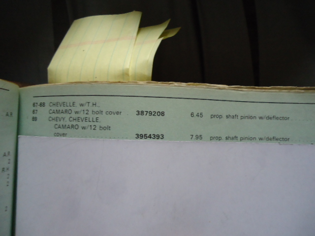

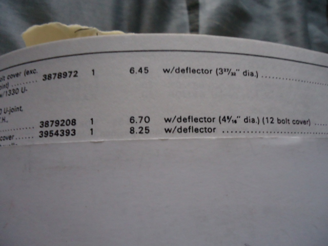

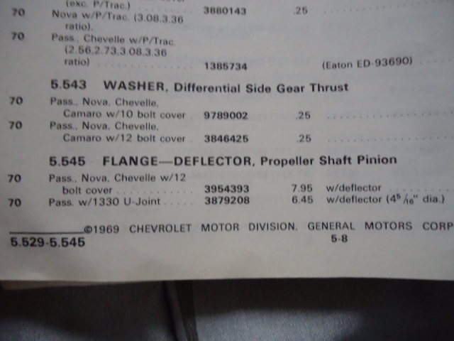

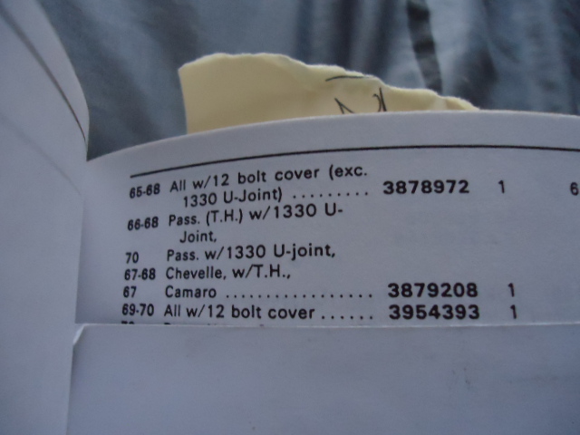

From my personal Library if it Helps..

That helps a lot.
Looks like the 4393 used a 1310 u-joint and the 9208 used a 1330 u-joint.
Wonder why the 67 12 bolt used the 9208 ant the 69 used the 4393.
Steve
