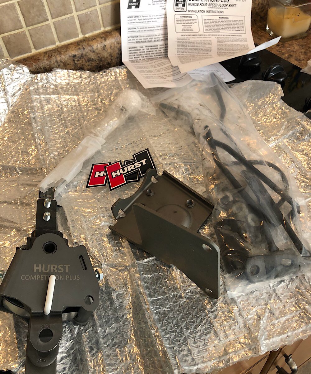

I want a hurst shifter to replace the factory Muncie shifter in my Nova. I did a few searches and found some good info. It appears I need a 1.5" offset to work with my console.
So I found this on ebay.
https://www.ebay.com/itm/1969-1970-C...53.m1438.l2649
I think it will work but the chrome stick also has a offset to it. Will it be too much offset?
Thanks for any advice.

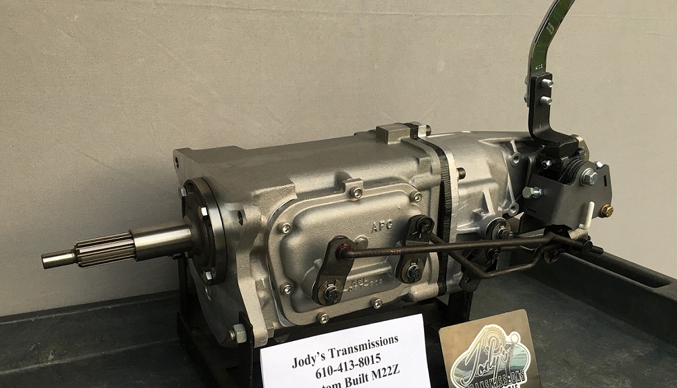

Originally Posted by Nova Pete View Post
1969 Nova with a console
The shifter listed in the catalog's won't work, if you have a '69 with a console you need this one - not listed in any catalog. I got mine from Jody Haag of Jody's Transmissions, fits perfect.

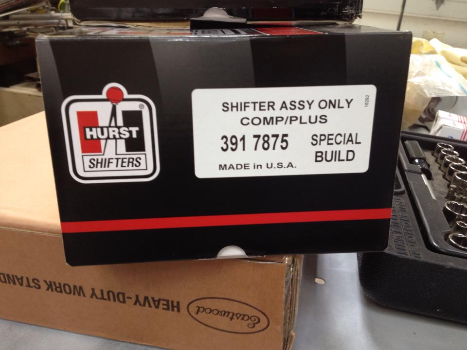

my old Hurst catalog lists the 1969 Nova shifter with console 391 7875
1969 Nova with console shifter 391 7879 is the replacement that comes with just shifter body and without the stick
the stick they list is the 4106
some people like to change the stick out for the 7236 or the 7436

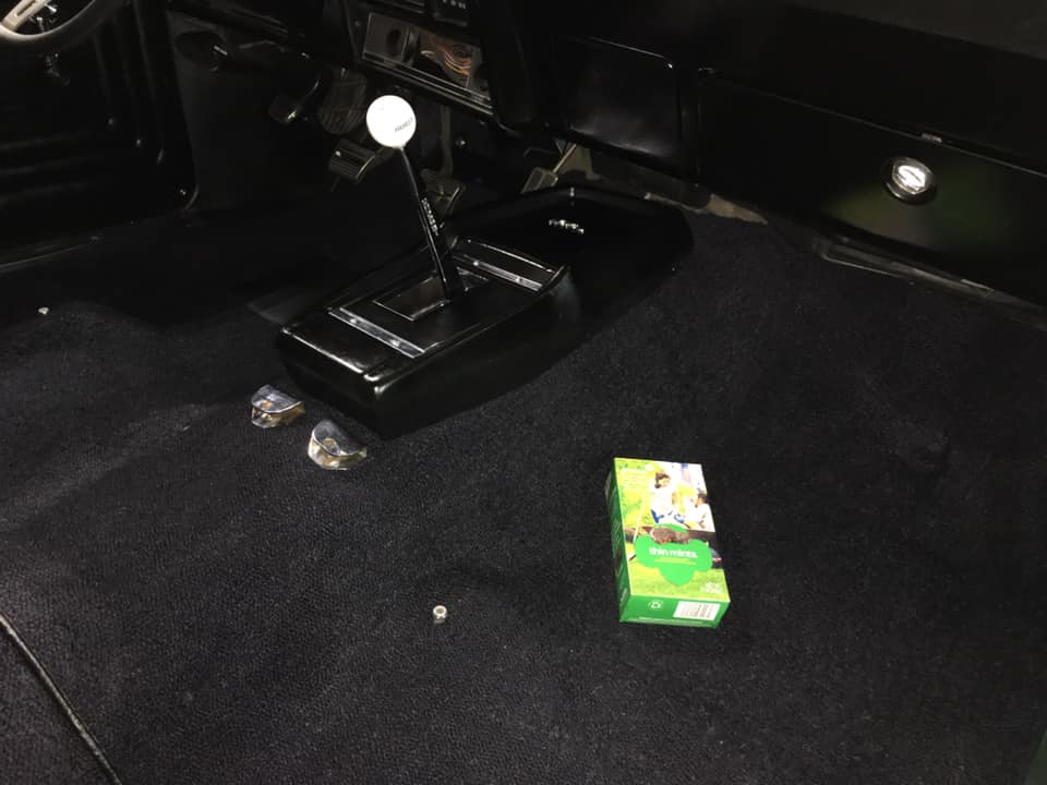

Were those seat belt holders an option for the Nova?
Thanks
