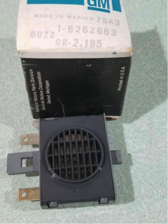

What is the correct buzzer for a '70 Camaro? '74 part books shows PN 6262663 for several GM models. Also, how is it wired and mounted?

The 70 Camaro did not use a separate "Buzzer" and relied on the horn relay on the driver's side radiator support to make that awfully irritating sound.

Well, I guess that's explains why I couldn't track one down for a '70. Thank you L16pilot for educating!

That style may have started in 72. My 72 Nova has this type buzzer, 72 may have been the first year.
